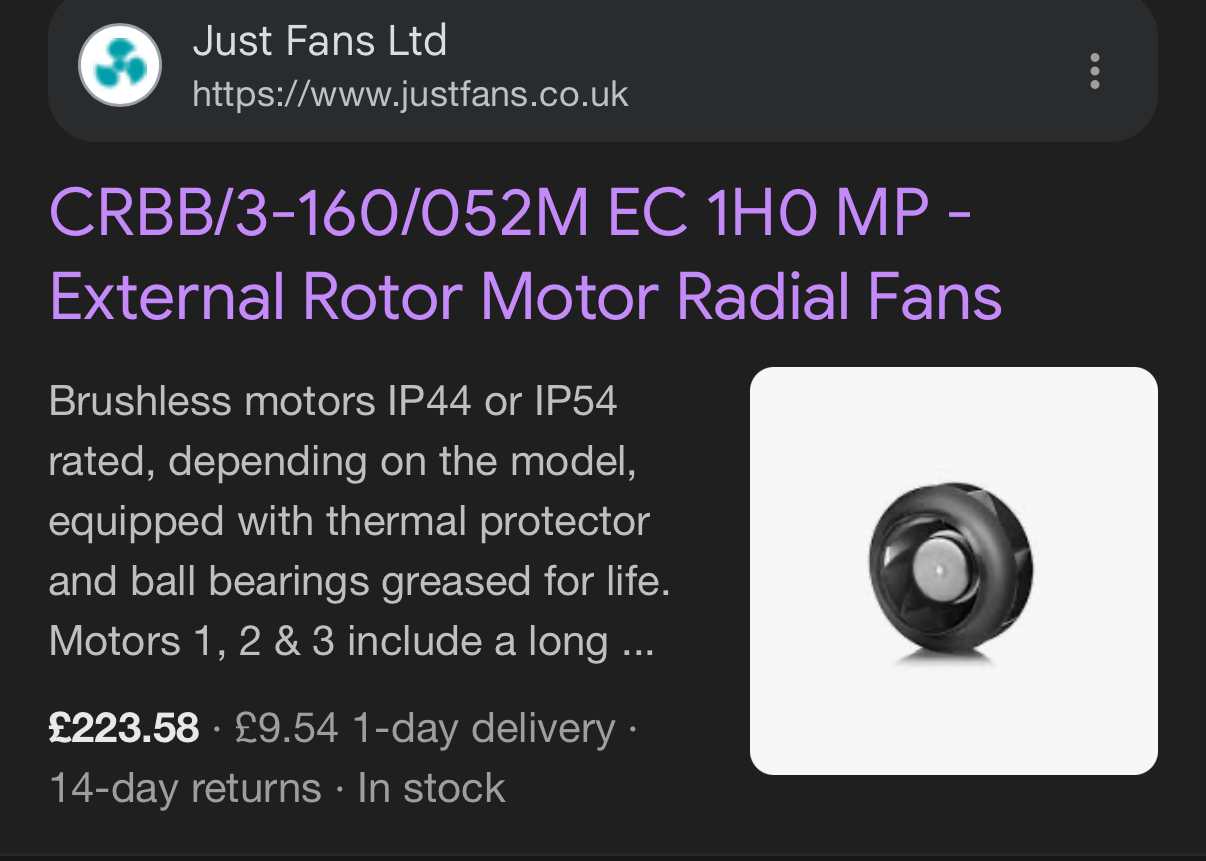

i took the unit apart and removed the motors. I tried to get them refurbished with the local electronics expert who deals with similar motors, he could not fix them.
After a research online I found one retailer who sold them and purchased. Unfortunately they came back to me after a week saying they only supplied packs of 16! And cancelled my order.
I rang manufacturer, Soler & Palau and I could order them but the lead time is about 7-8 weeks as rhey need to be ordered from Spain.
The motors are from Soler & Palau
CRBB/3-160/052M EC 1H0 MP.
Do the motors have to be exactly the same or could I find a replacement for them? Google does not return many results and I was advised by the manufacturer that there is probably limited stock in the UK. Could anyone point me in the right direction?
