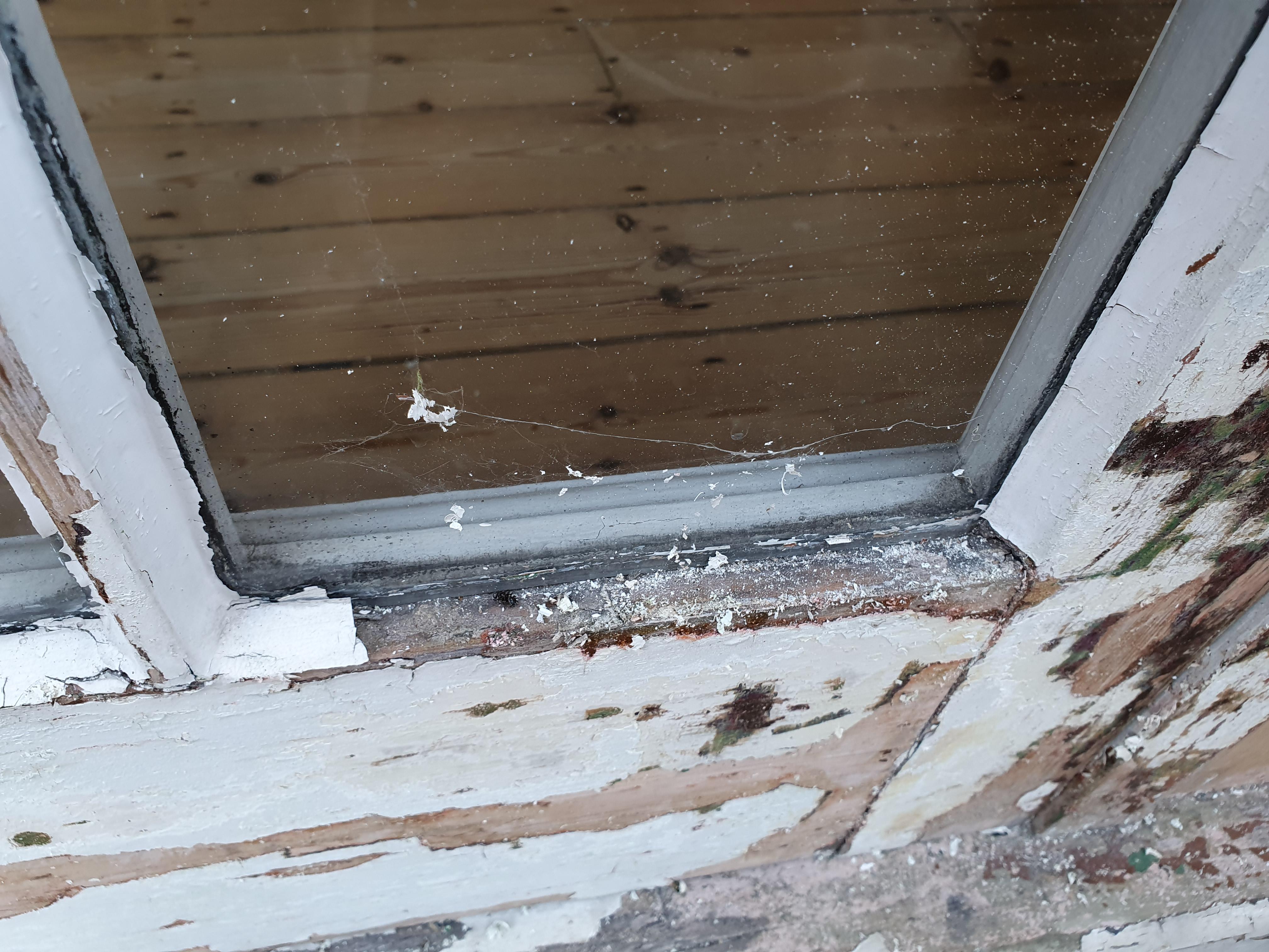

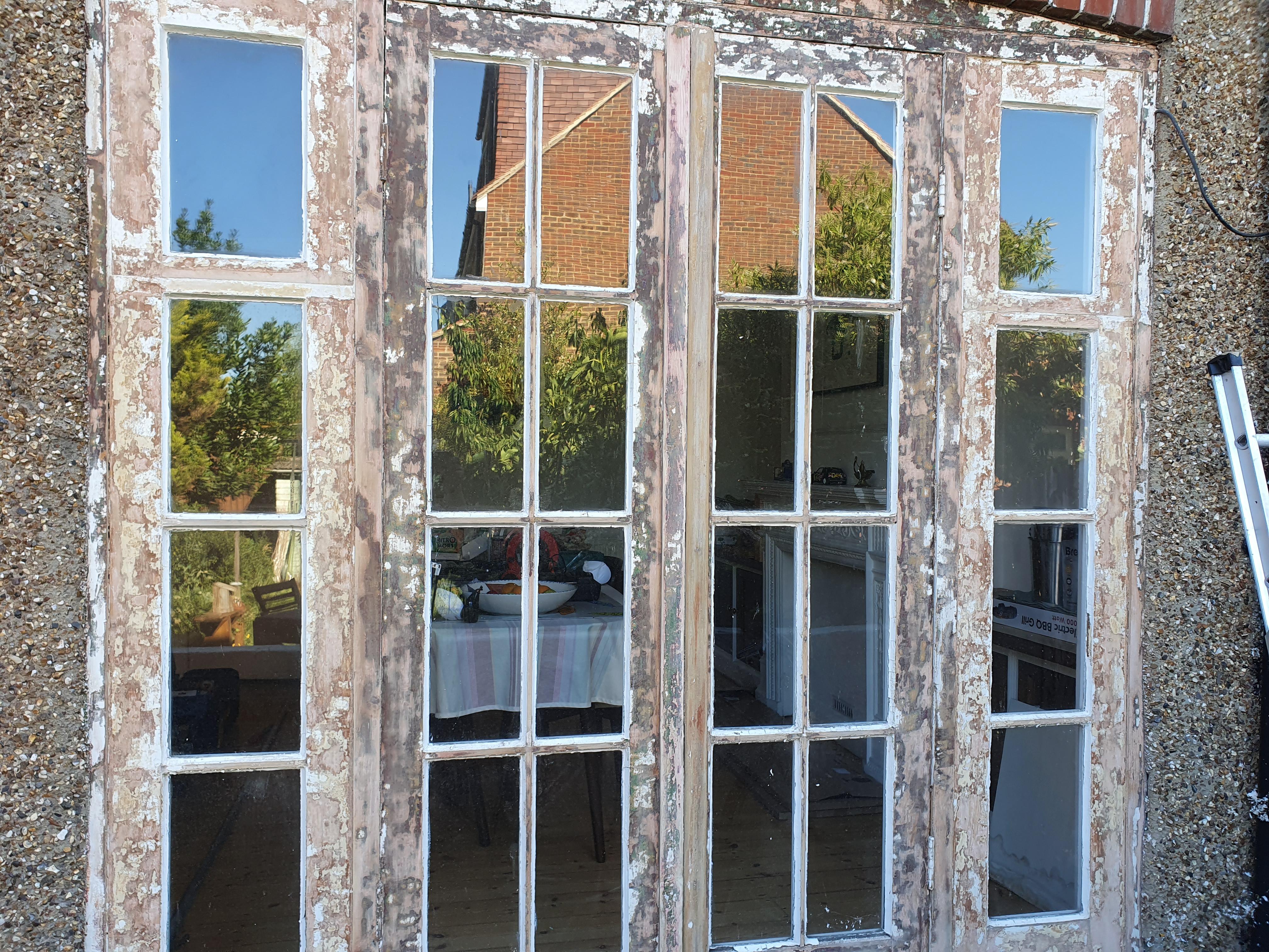

The house was built in 1934 and the windows may be as old as the house. It is a wooden frame with 2 opening panes in the centre and 2 fixed panes on the sides. I noticed the paint was flaking off so decided it would be a good job for a bank holiday weekend to strip the paint and give it a new coat. I then realised that it has at least 5 layers of paint of different ages and the sealant around the glass units is flaking suggesting I should renew it.
As I'm in for a more complex project than initially planned, I wondered if I could take this opportunity to replace the single panes of glass with double glazed sealed units. I am aware that double glazed sealed units would be a fair bit thicker than the current single units. So my questions are:
  • Can it be done?
  • Where can I get double glazed units?
  • How can I size the thickness of the glass + spacer?
  • Do I need to fit the new units differently than the old ones?
  • Will the weight on the frame increase and is that a problem?
I attached some photos of the windows.
