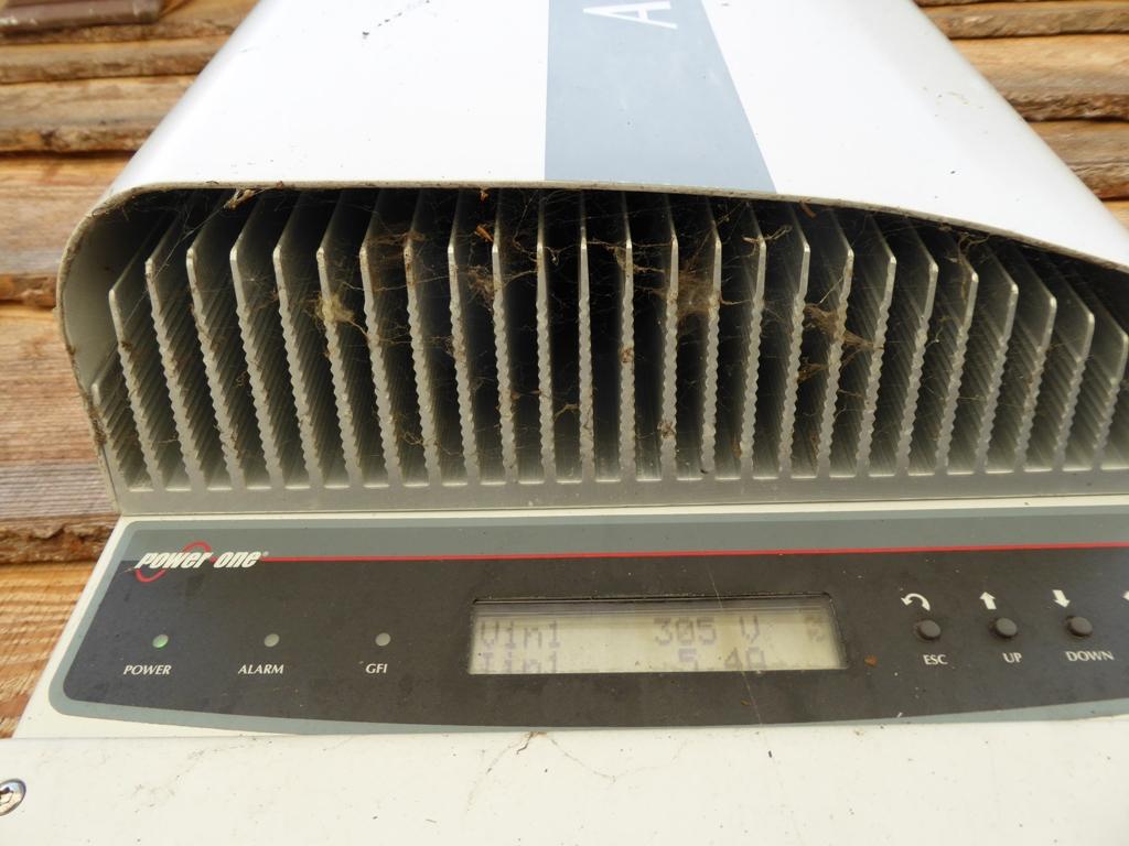

pulhamdown Posted May 22, 2019 Share Posted May 22, 2019 Today I received a letter from BT Solar ltd. They say that my inverter warranty has now expired, correctly, and a health check and service is required to validate the warranty. I wonder how many people fall for that one. But just out of interest, is there really anything in an invertor to service, and how would they go about doing a health check. It either works or is doesn't, surely? And what is a good life for an invertor? We've had our Sunny Boy for seven and a half years. Link to comment Share on other sites More sharing options...
Jeremy Harris Posted May 22, 2019 Share Posted May 22, 2019 The only thing to check is that the heat sink isn't full of cobwebs (seems to be a problem with ours - I have to vacuum it out once a year or so) and that it's still functioning. There are no serviceable parts, and I suspect that any "service" might be just a way to apply pressure to buy a replacement inverter. The life of an inverter is probably around 10 years or so on average, perhaps longer if it is in a cool location, shorter if it is in a warm location. Temperature is the biggest factor regarding life, as the most common parts to fail are the commutation capacitors, and these have a life that is very temperature dependent. 1 1 Link to comment Share on other sites More sharing options...

Jeremy Harris Posted May 22, 2019 Share Posted May 22, 2019 Just been out to look at ours, as I've not cleaned it since last year. Seems to have the usual cobwebs: Link to comment Share on other sites More sharing options...

scottishjohn Posted May 22, 2019 Share Posted May 22, 2019 if heat is a problem why do they not have a fan ? Link to comment Share on other sites More sharing options...
Jeremy Harris Posted May 22, 2019 Share Posted May 22, 2019 8 minutes ago, scottishjohn said: if heat is a problem why do they not have a fan ? Some do, but it then becomes a critical point of failure. If the fan wears out, then the inverter may overheat and fail, and it's likely that a fan may well fail earlier than the commutation capacitors. Link to comment Share on other sites More sharing options...
