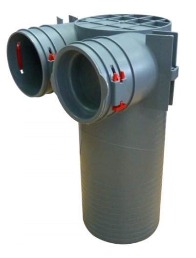

I need to cut the plastic plenums that are fixed in position, can anyone reccomend the best way to do this? I was thinking of buying a cheap reciprocating saw like this one:
https://www.diy.com/departments/performance-power-700w-220-240v-reciprocating-saw-prs700c/3663602796176_BQ.prd
Or should i just use a fine toothed hand saw?

need a lot more info than that to make a comment
how big are holes needed , or is just trim what is sticking down in picture?

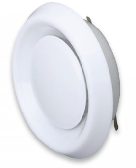

It's not cutting a hole, the 125mm hole has already been cut.
It's trimming the end off the plenum (125mm diameter)  flush with the ceiling so I can then attach the air valve

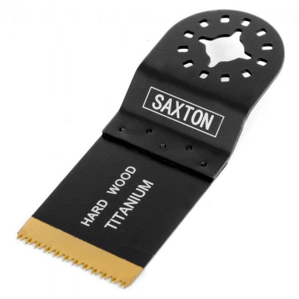

1 minute ago, ultramods said:
@JSHarris, @Bitpipe can you recommend a cutting attachment please as there are so many to chose from?
I borrowed my sparky's Makita with whatever cutting tool he had on think it was about 50mm wide. The plastic on those plenums is relatively soft and easy to cut, I just plunged the cutter in and out in a circle, took a minute or two for each one.
Again, doesn't matter if the cut is perfect as the ceiling fitting covers it up completely.
  • Thanks 1
Share this post
Link to post
Share on other sites
As above, I think I just used the wood blade, like this:
BTW, I've found Saxton blades to be good value and better quality than the blades that came with my Bosch multitool.
