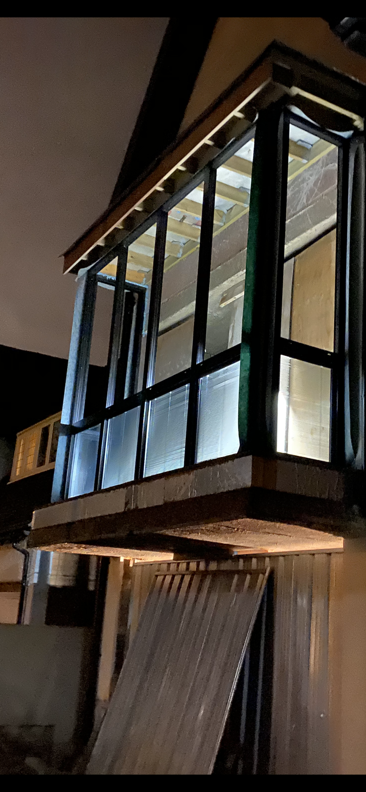

With Velox window openings there is a Velox board each side and above, but not below. Does it not work to put a board down as an under window sill and then pour the concrete? If there is not a horizontal lower board do you have to stop the concrete pour every time you reach a window sill level?
If there is no lower horizontal board how do you support the window in the insulation layer??
Any thoughts?

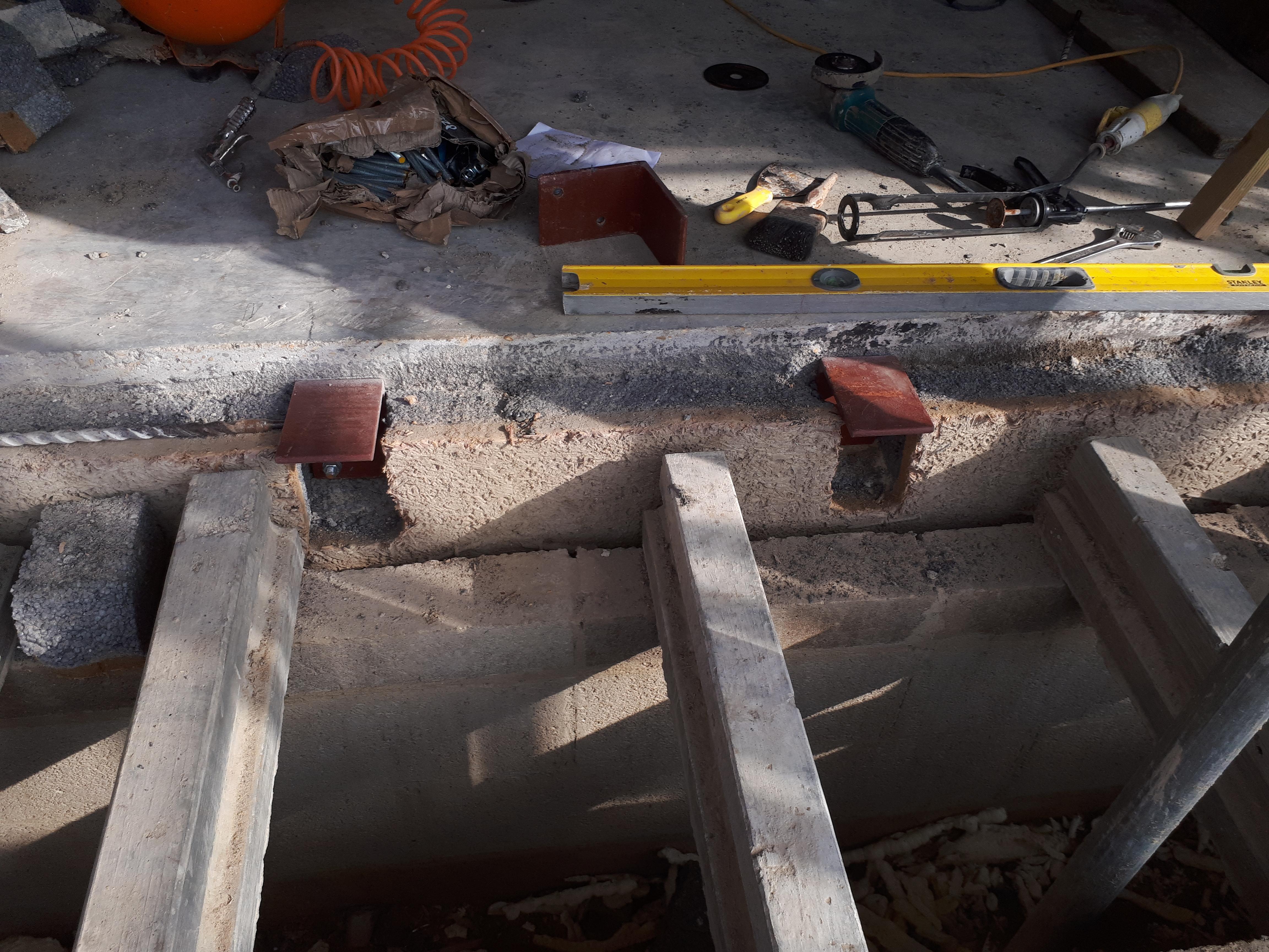

On 01/03/2019 at 13:09, D Walter said:
Hi, one of the issues which has arisen with our Velox build is how to support the weight of the large triple glazed windows. I assume that this is an issue with most ICF builds.  The window frame is approximately 100mm deep.  At first floor level the window frame sits approximately 15mm in from the exterior 35mm Velox panel.  This means that it is resting entirely above the 180mm of exterior EPS insulation.  The attached picture shows the "angle" we are using at ground floor level (where there is only 80mm of EPS to ground FFL) to support the window frames, bolted through into the concrete floor.
I would be interested to hear what solutions other people have used in ICF builds.
I also triple glazed and some of my windows are huge. I went with a half and half approach generally and placed the window partially on the insulated form work and partially on the concrete for smaller windows. However with larger windows I decided to build a Newton block plint directly off the floor then insulated them to the exterior.

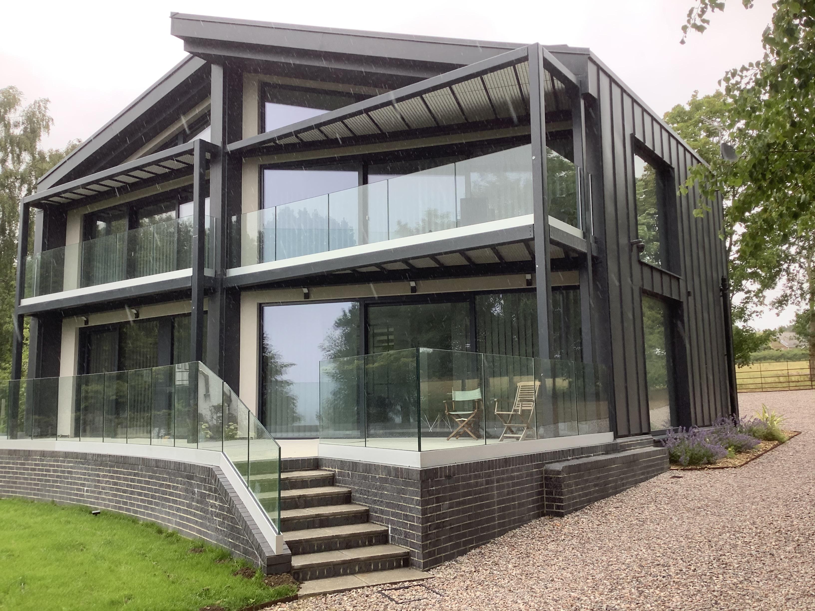

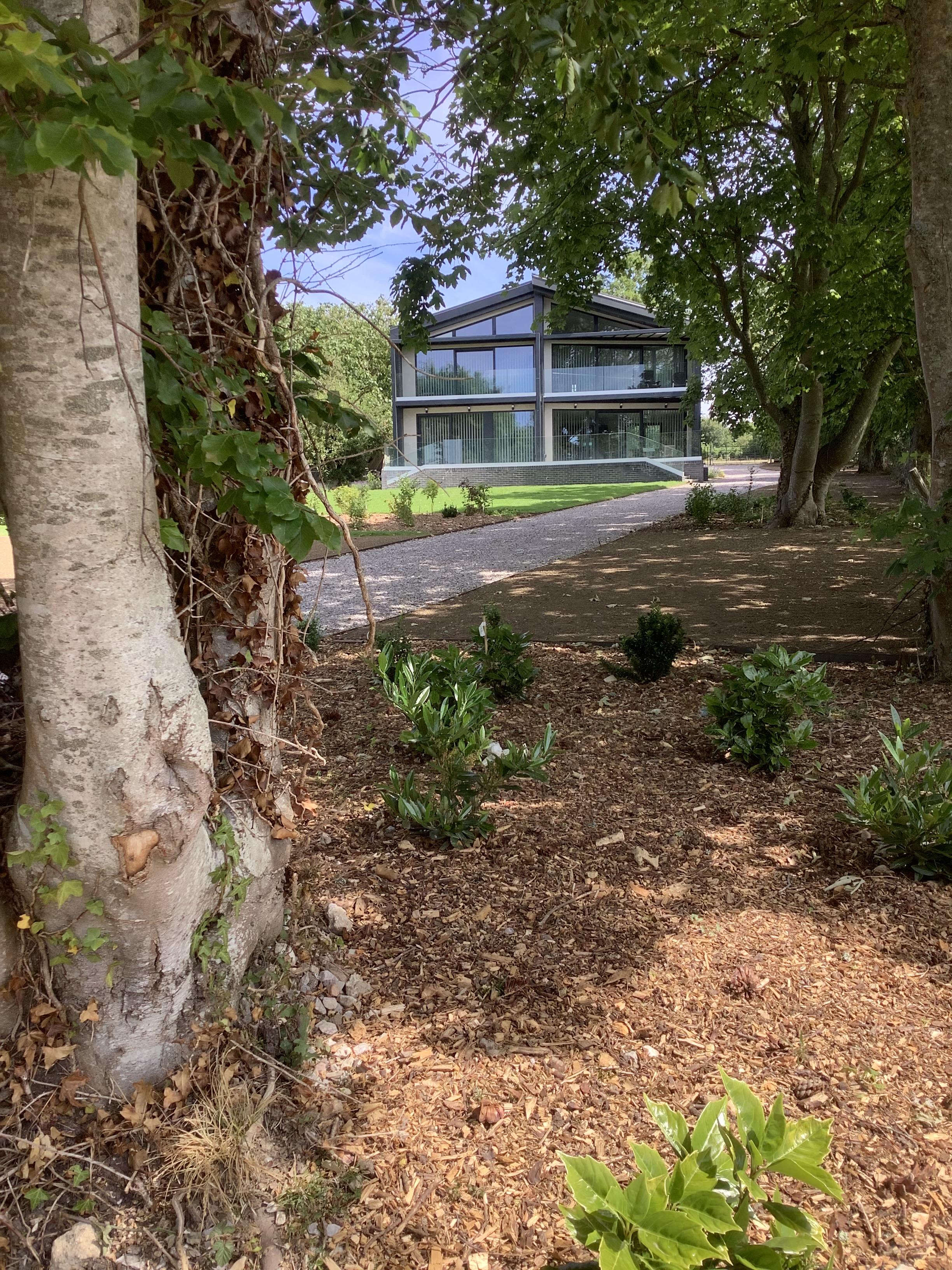

I have not submitted any pictures of our finished house so here are a few exteriors, with the landscaping almost finished.  There is a bit of estate railing, steel edging to the drive and a bit more topsiol required.  With the estate railing and the edging for the drive and flower beds we buy in the steel, my builders do the setting out and the IMG_0145.thumb.JPG.5e93c0392680f0483660eeed54fe90eb.JPGheavy lifting and I do all the welding on site.  Thanks again for all the assistance and encouragement.
David

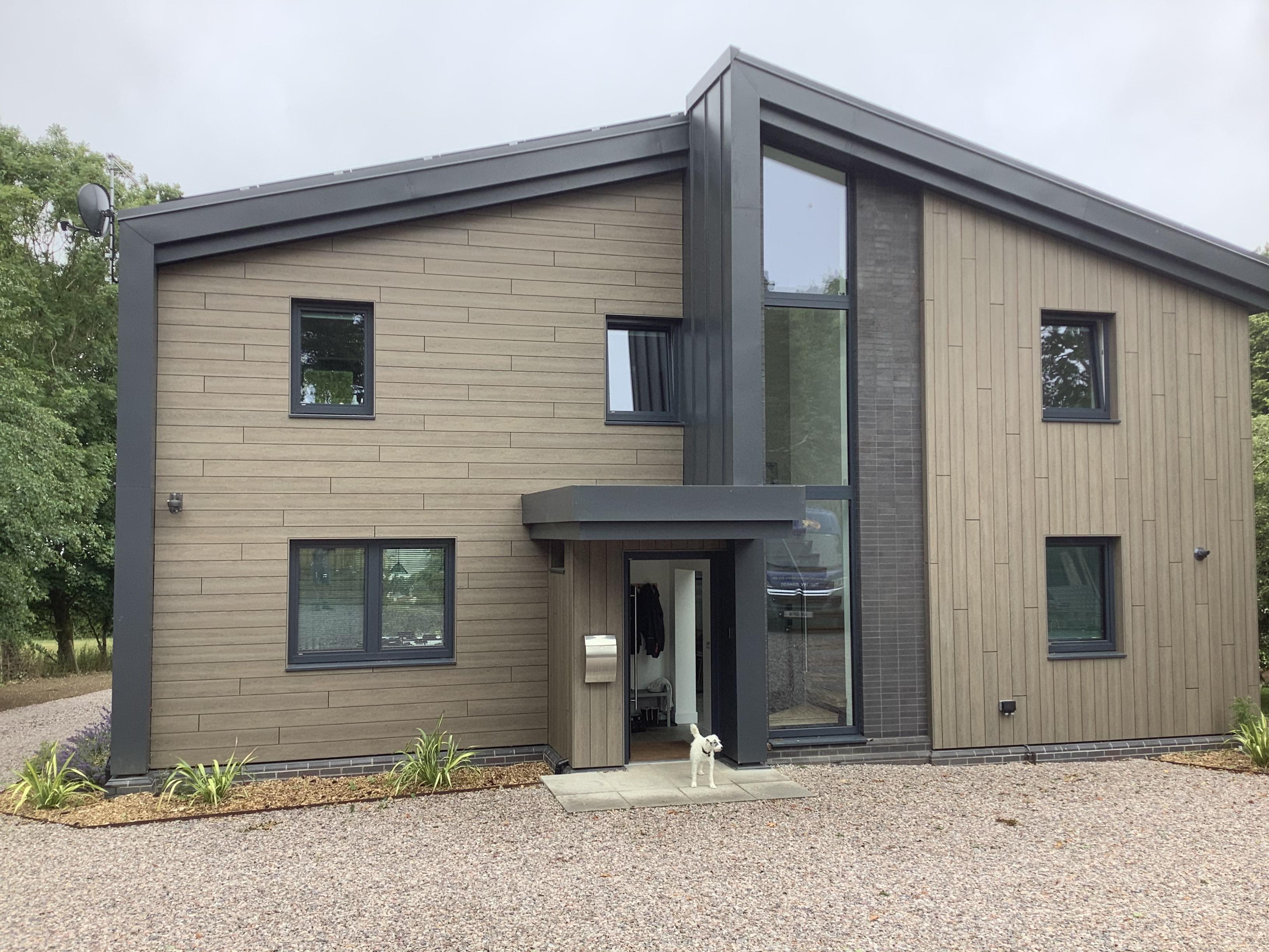

That is a great looking house.  The cladding looks looks an expensive mix.  Are you pleased with the Trespa?

Thanks Mr Punter.  We spent lots of time looking at timber cladding all over the place and particularly in coastal enviornments like ours and so much had weatherd badly (uneven with lots of blackening) that we decided on the Trespa.  Speaking to local builders the general impression was that timber cladding did not fare well in the Island.  Yes, very pleased so far and hopefully it will wear well.  The Tata steel cladding is also doing well so far but it is very early days.....
From the picture I thought it was pre patinated zinc.
Share this post
Link to post
Share on other sites
Well, you got the Trespa right so 👍.  I did look at the zinc but very costly and more dependent on the quality of the fitting than with the Tata.

1 hour ago, Russell griffiths said:
That looks excellent @D Walter👍👍👍
Thanks Russell.  About 10 years from starting clearing the site to finishing.
Share this post
Link to post
We have used Trespa and Tata steel on our build and very pleased with them
