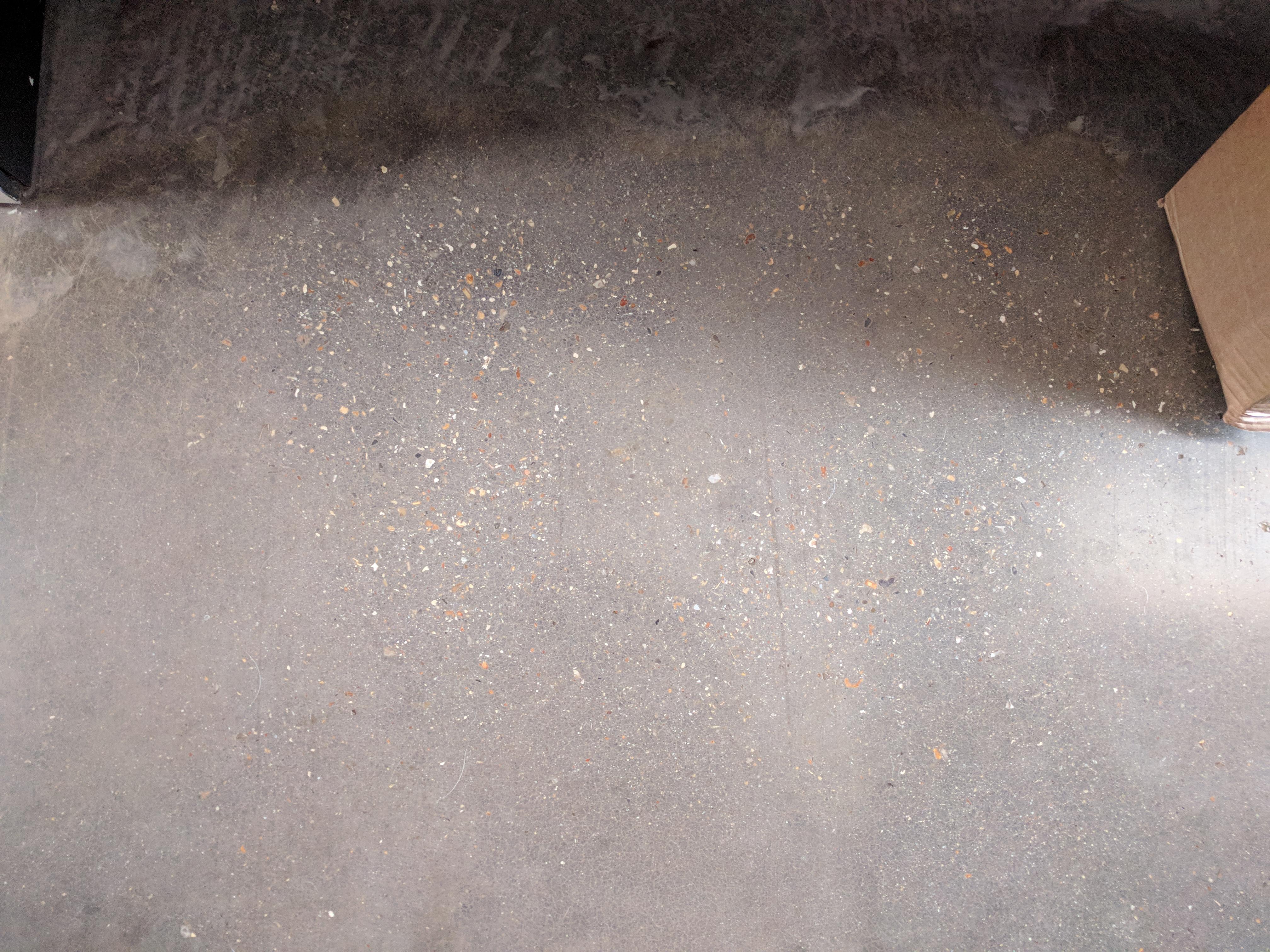

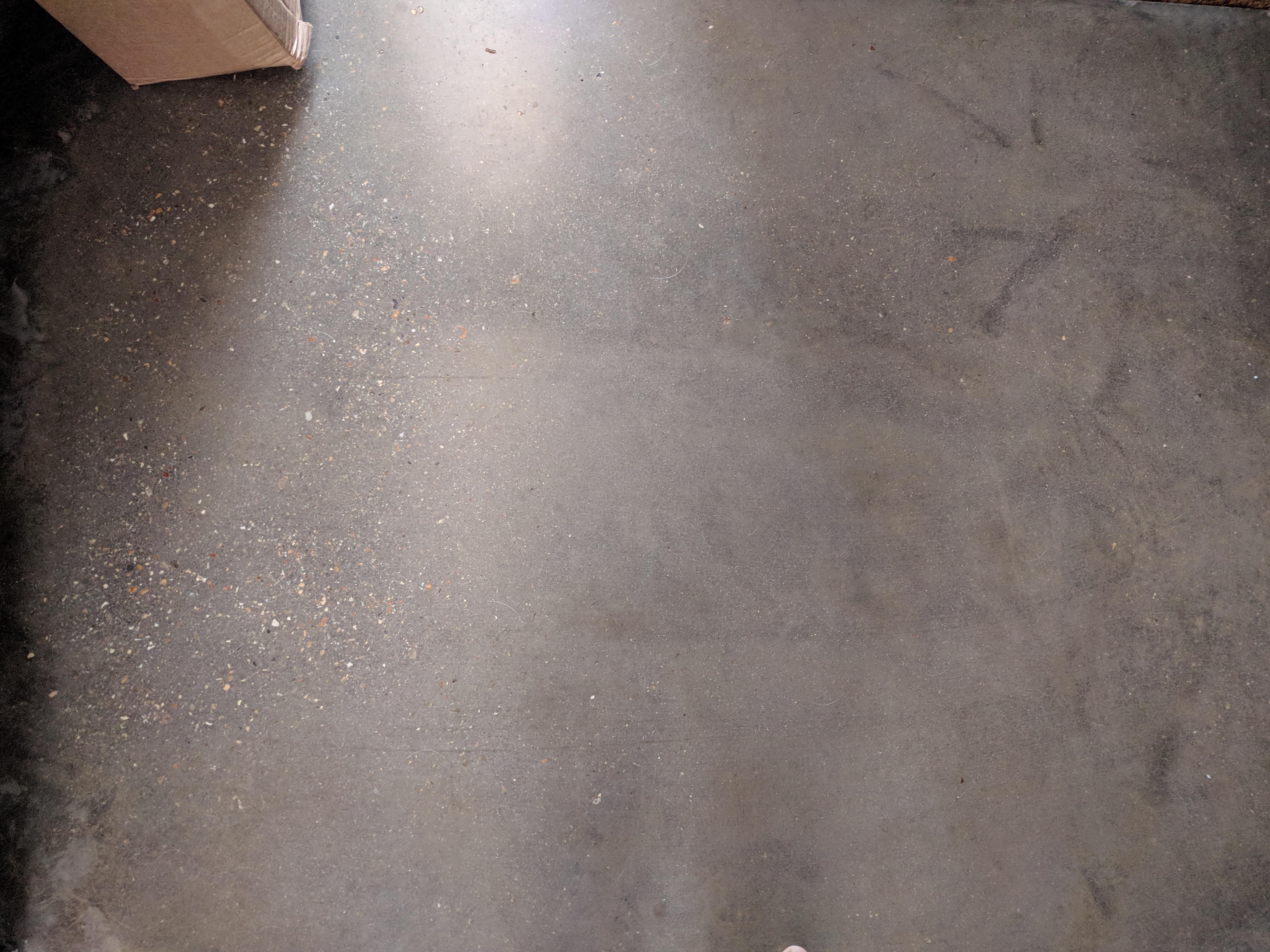

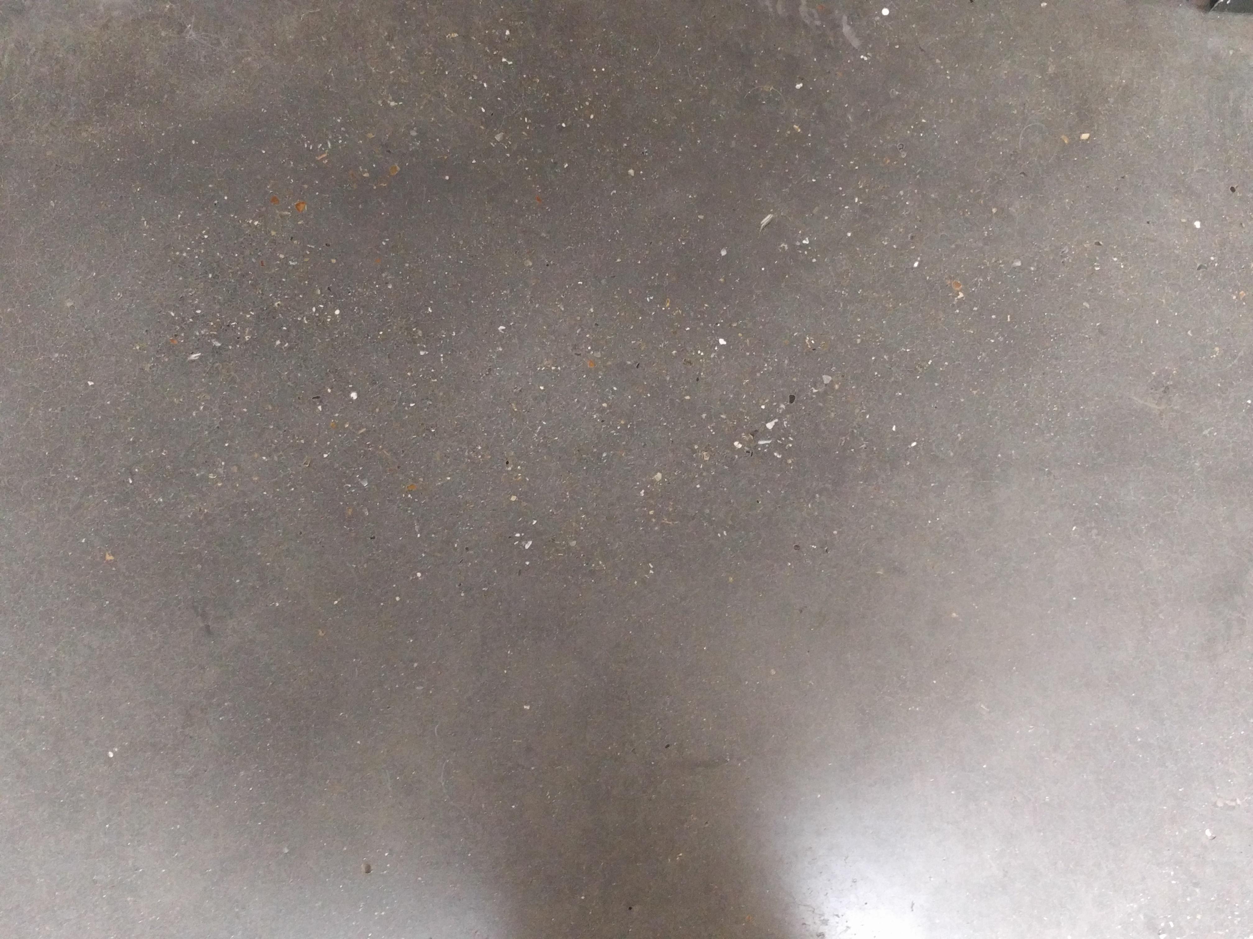

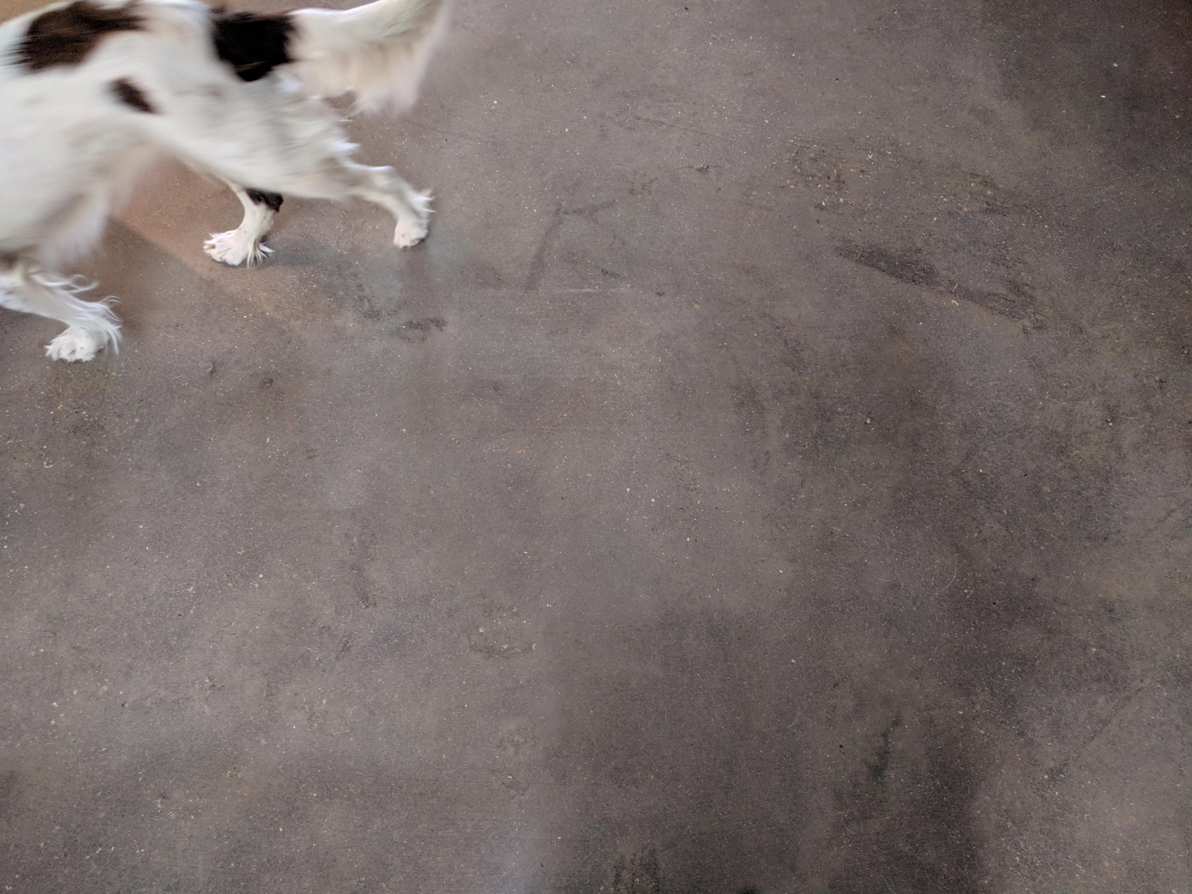

The following photos are all from the same area in the house earlier today (took them but didn't have time to post). It's actually really hard to capture the real-life effect of the concrete!
Relatively speckled area:
Less speckled (+ crazy dog):
Transition between speckled and less speckled area:
Another view:
