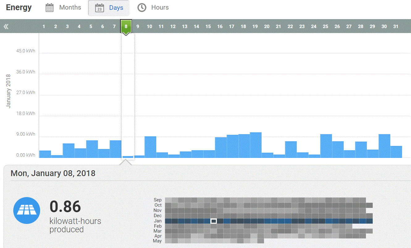

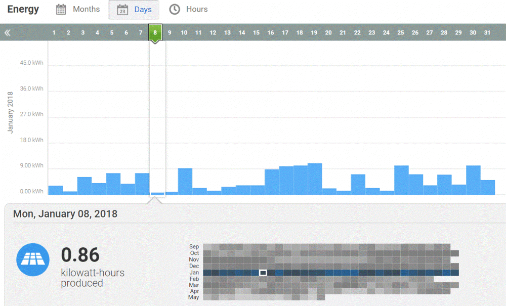

As an example, here's the daily generation for January this year on my 8.5kW system:
There were 14 days that generated less than 4.8kWh, and that's ignoring charge/discharge inefficiencies, SoC limitations, and the fact that at least some of what was generated will have been consumed and therefore not available for storage.
I just checked, and December was worse, with 19 days that generated less than 4.8kWh.
Remember, this is an 8.5kW system. A 4kW system would have generated less than half what's shown above. In fact, a 4kW system at my location (Hampshire/Surrey borders) would only have managed 5 days above 4.8kWh in January, and only 1 (and only barely!) day in December.
