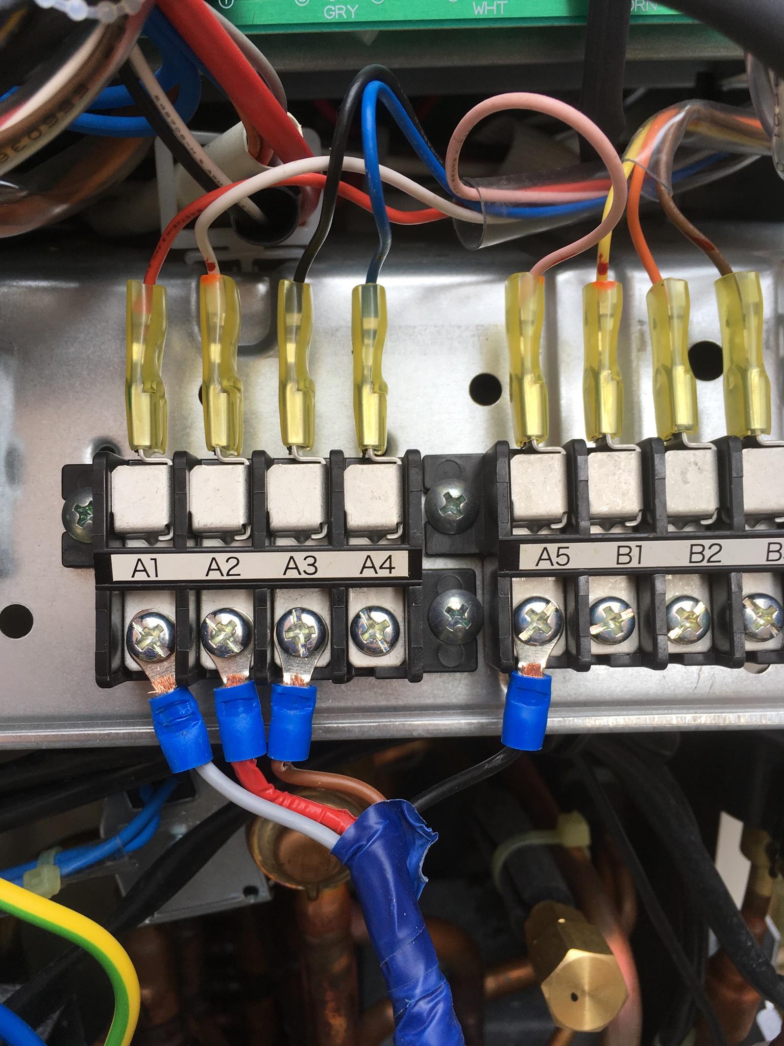

On 08/12/2018 at 06:34, testom said:
@PeterW I have found that B2 & B3 terminal gives +24V as a output signal.
I have finnaly plugged two small LED`s there.
And I must say this LED`s gives  nice indication to what is actually going on with ASHP.
@testom how have you wired these LEDs...?? Where have you taken to ground ..??
