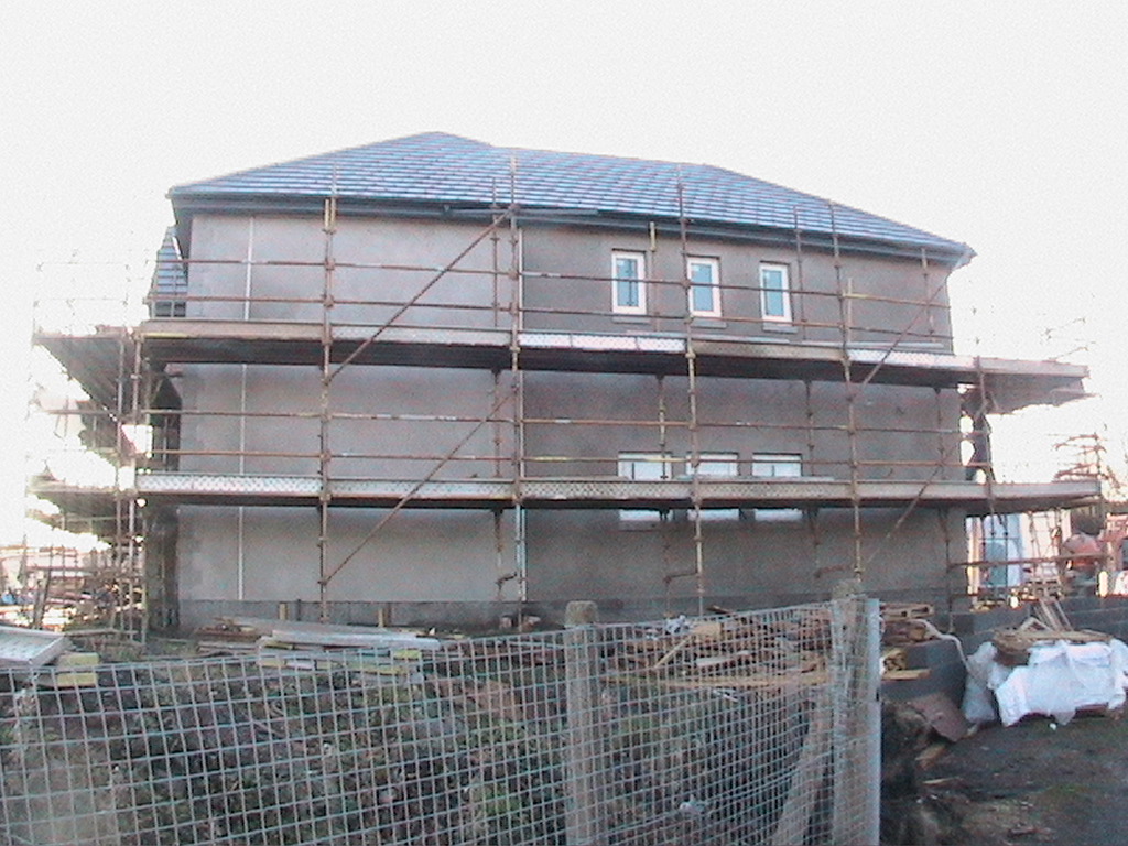

It's a job to see how how he could fall off the first lift of that. It has the correct toe boards and double hand rails.
It's also a mystery how the roofers tiled the roof :ph34r: or has the top lift been removed post tiling?

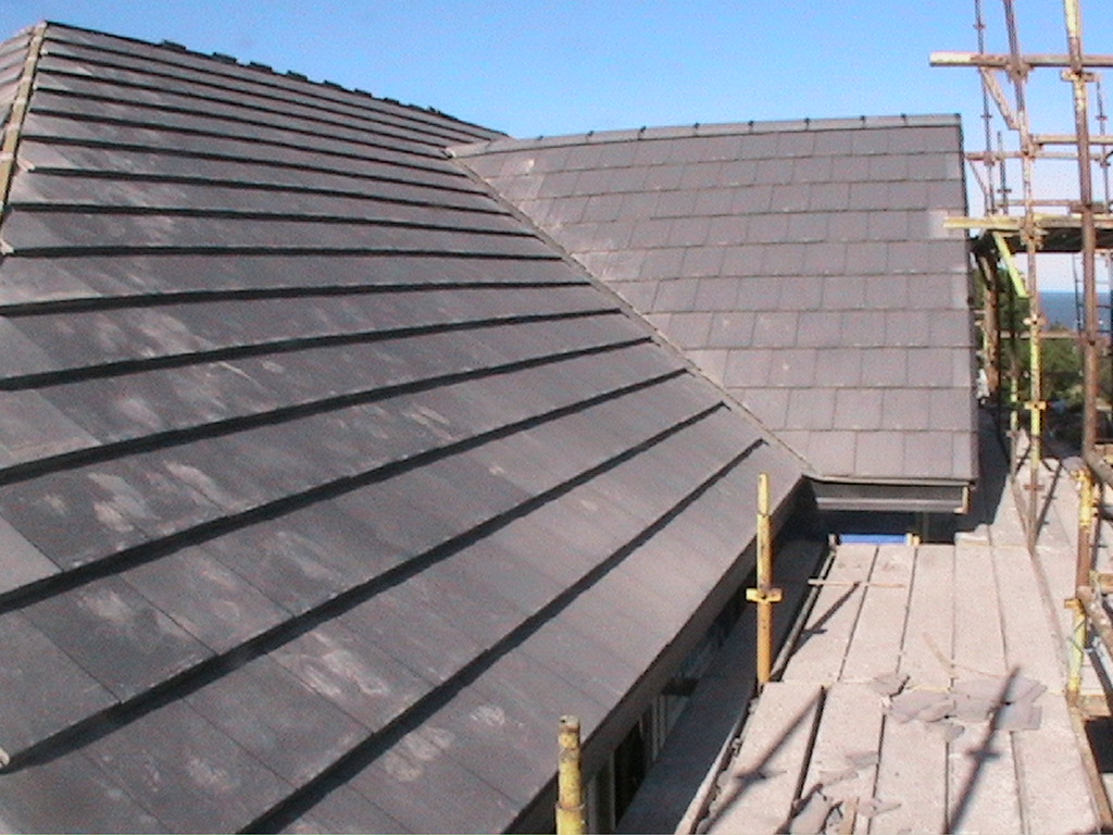

Their levitation skills weren't that good :D - the top lift was removed once the roof was finished.

Needless to say - it wasn't me taking the photos! I didn't even venture up to the first lift!
