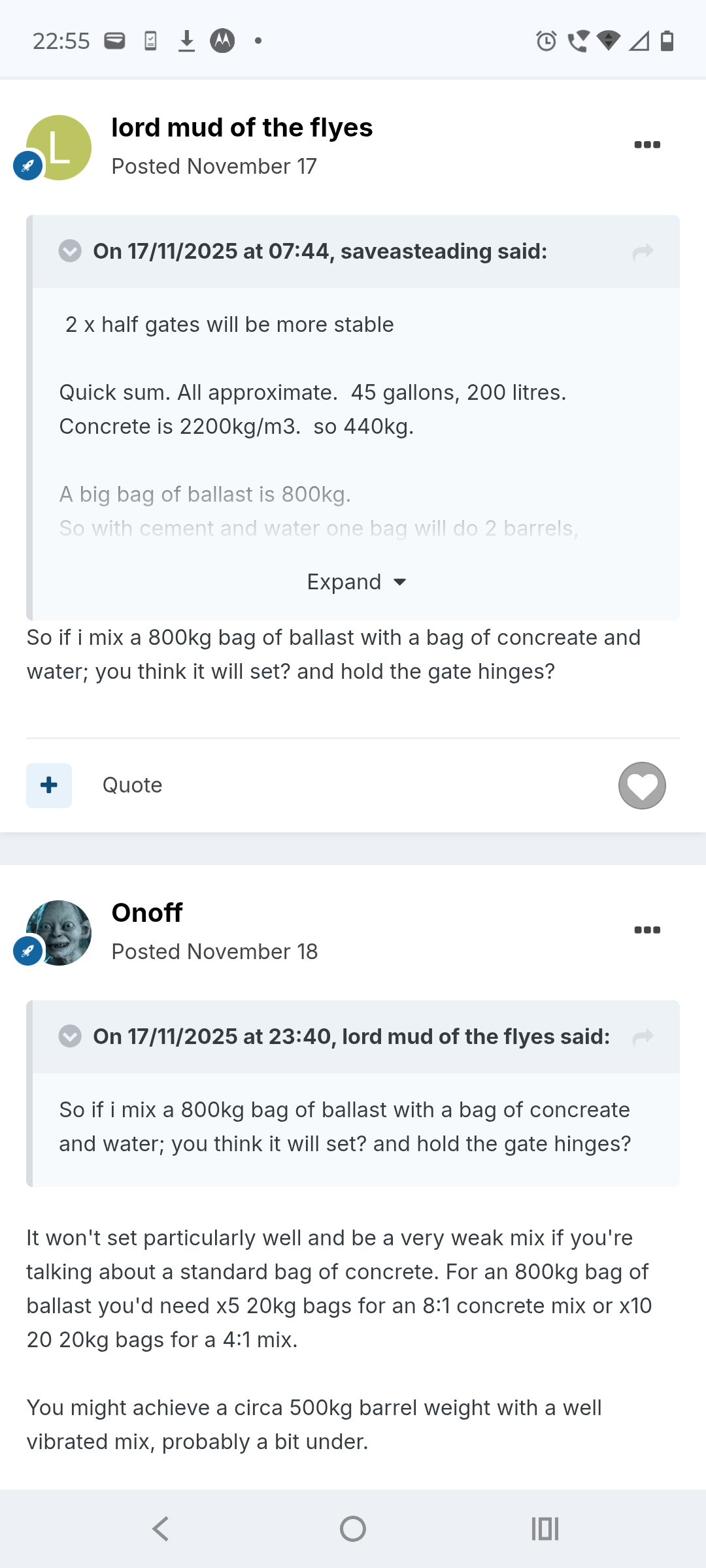

lord mud of the flyes Posted 19 hours ago Author Posted 19 hours ago I ordered a 800KG bag of ballast and 6 bags of cement and had them delivered by Travis Perkins AS SOME BRIGHT SPARK SOMEWHERE SAID THAT WOULD BE ENOUGH BALLAST FOR 2X 45 GALLON DRUMS And I started the work. Well i have now run out of ballast! I was told that an 800kg bag would do me 2X45 gallon/205 litres drums and it has only done 1 and 2/3rd of the drums. I am still 1/3 of a drum short!

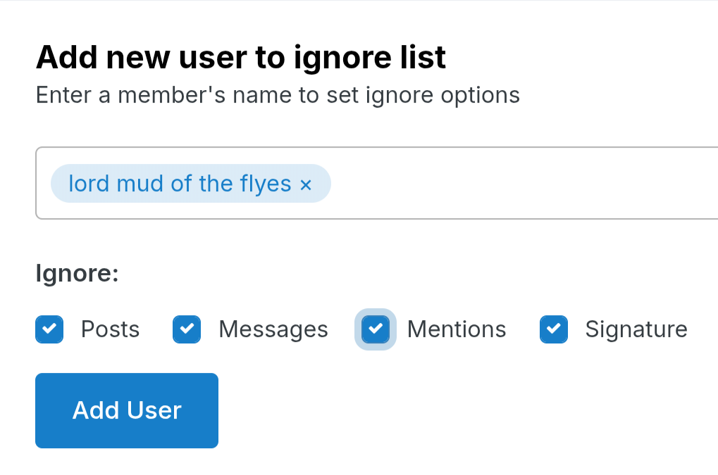

Onoff Posted 19 hours ago Posted 19 hours ago 30 minutes ago, lord mud of the flyes said: I am still 1/3 of a drum short! Couldn't have put it better myself. 1

JohnMo Posted 7 hours ago Posted 7 hours ago 12 hours ago, lord mud of the flyes said: I ordered a 800KG bag of ballast and 6 bags of cement and had them delivered by Travis Perkins AS SOME BRIGHT SPARK SOMEWHERE SAID THAT WOULD BE ENOUGH BALLAST FOR 2X 45 GALLON DRUMS And I started the work. Well i have now run out of ballast! I was told that an 800kg bag would do me 2X45 gallon/205 litres drums and it has only done 1 and 2/3rd of the drums. I am still 1/3 of a drum short! Measure twice and all that. At least you can calculate how much extra you need now...
