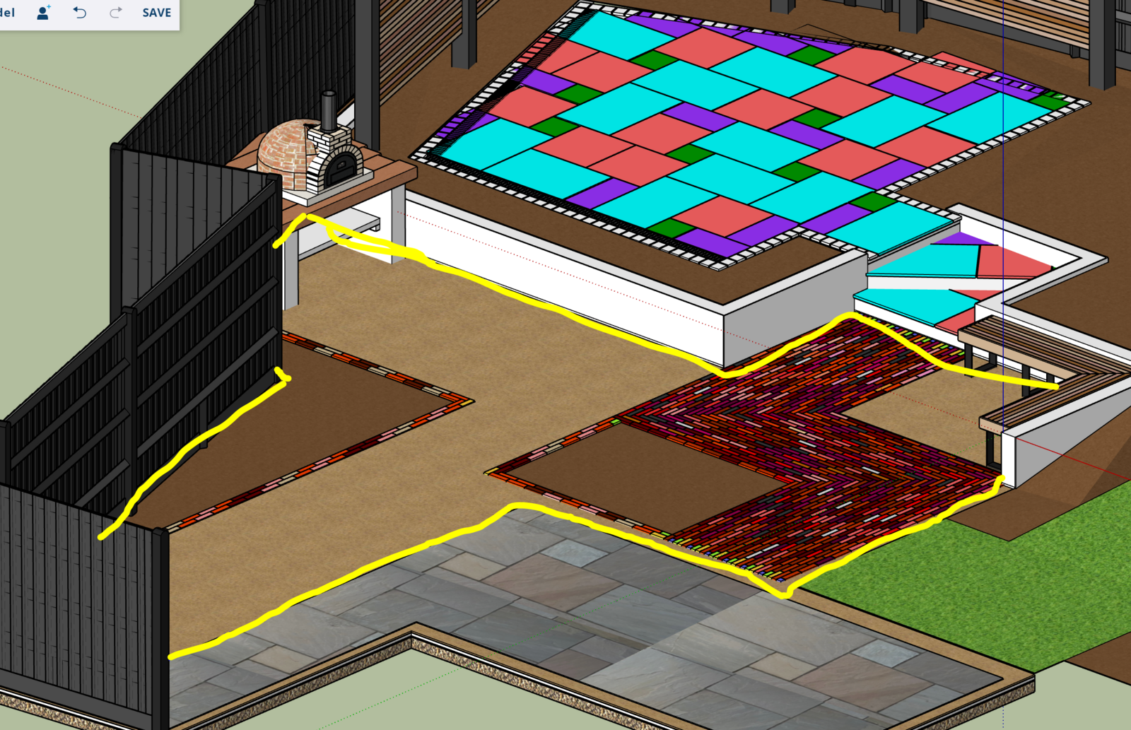

machtucker Posted April 16, 2024 Posted April 16, 2024 Hi everyone, Well the weather is looking to be better next week and I'm on leave so planning on doing a bit more landscaping in the garden. I'm going to excavate the bottom part of the garden (bounded by the yellow line in the model). There is a clay paver path to be laid on top of sharp sand bedding layer and also 6mm gravel in the other areas with a stabilisation layer and 10-15mm bedding layer of sharp sand. I'm planning to use a 100mm MOT Type 1 subbase layer for the whole lot. The question is should I put a fall on it or will it be OK level for drainage purposes? Many thanks, Ed
ProDave Posted April 16, 2024 Posted April 16, 2024 Compacted MOT1 does not drain well, so don't expect water to drain through it quickly, so a fall would make great sense. 1

saveasteading Posted April 16, 2024 Posted April 16, 2024 18 minutes ago, markc said: road planings compact very well and drain well too. They shouldn't if well mixed and compacted. A road is a mix of stones not unlike MOT I , but stuck together by a glue of bitumen. If it is supplied as all big stones then it will have gaps and drain. If it is footpath material or surface dressing, then it is weak but solid. I think the best of it goes back into new road surfacing these days, and the rest is sold off. 4 hours ago, machtucker said: a clay paver path to be laid on top of sharp sand bedding layer So its best to lay the base to a fall and try to keep the sharp sand depth consistent . And it will be easier to lay. 1
machtucker Posted April 17, 2024 Author Posted April 17, 2024 (edited) On 16/04/2024 at 15:58, saveasteading said: They shouldn't if well mixed and compacted. A road is a mix of stones not unlike MOT I , but stuck together by a glue of bitumen. If it is supplied as all big stones then it will have gaps and drain. If it is footpath material or surface dressing, then it is weak but solid. I think the best of it goes back into new road surfacing these days, and the rest is sold off. So its best to lay the base to a fall and try to keep the sharp sand depth consistent . And it will be easier to lay. Yes that's how I will do it, just like I did with the patio. I was wondering whether I could get away without a fall though. I did read something on Paving Expert website that talked about a suds compliant solution which requires a different subbase with fewer fines. Edited April 17, 2024 by machtucker
