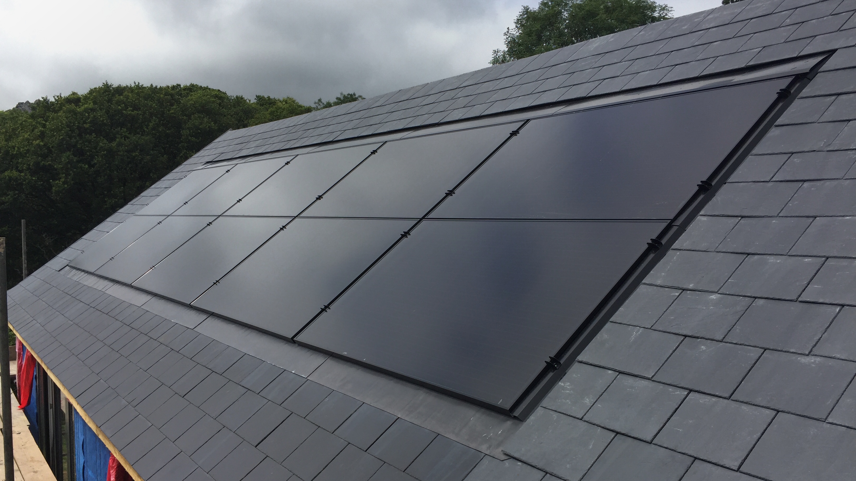

Barney12 Posted July 16, 2017 Author Share Posted July 16, 2017 So here's the South roof. The result of 3 days work by me and two friends. If you combined the knowledge of all three of us then I reckon you'd be half way to a pro roofer Actually one of the guys has done a lot of roofing but he's a bit agricultural, took me ages to convince him to use slate and half, he said it was fussy crap Note that we decided to scrap the sticky flashing stuff supplied with the GSE solar trays and instead went for lead. I think it was the right decision in our exposed position. I really don't like the way the flashing trays 'kick' the slates at the sides and top but if you install them to spec then there is nothing you can do about it. But I'm probably being fussy! If you're very observant you'll notice the colour difference on the slates below the solar PV. That's because even with two coats of patina oil as soon as it rained it chucked white residue all over the slates so I decided to clean it off. How did we do? 6 Link to comment Share on other sites More sharing options...

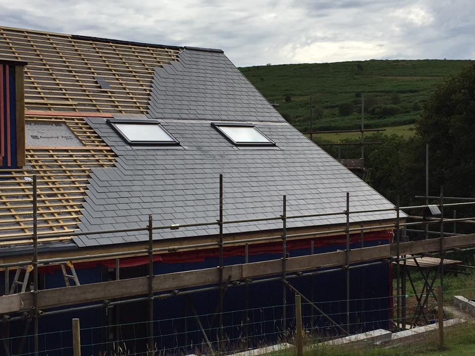

Barney12 Posted July 18, 2017 Author Share Posted July 18, 2017 North roof now underway. The pitch change is where the metal seam roof was supposed to be going on the lower half. Ditched due to the incompetence of Tata steel and getting generally fed up! However, I'm quite pleased with how the slate is looking. The lead flashing at the pitch change actually breaks the roof up. Holly mother of feckinuss those tripple glazed Velux dormers were heavy. 60 kg a peice 3 Link to comment Share on other sites More sharing options...
PeterW Posted July 18, 2017 Share Posted July 18, 2017 What size are the Velux....? I'm looking forward to some 78x140s....... Link to comment Share on other sites More sharing options...
Barney12 Posted July 18, 2017 Author Share Posted July 18, 2017 55 minutes ago, PeterW said: What size are the Velux....? I'm looking forward to some 78x140s....... 134 x 98. So yours will be just a little lighter Not much though! Link to comment Share on other sites More sharing options...
Construction Channel Posted July 18, 2017 Share Posted July 18, 2017 I assume you took the glass out of the frame first.... my 78x98s were a measly 44 kg Link to comment Share on other sites More sharing options...
Barney12 Posted July 18, 2017 Author Share Posted July 18, 2017 18 minutes ago, Construction Channel said: I assume you took the glass out of the frame first.... my 78x98s were a measly 44 kg Yes. But the frame weighs bugger all! Link to comment Share on other sites More sharing options...
