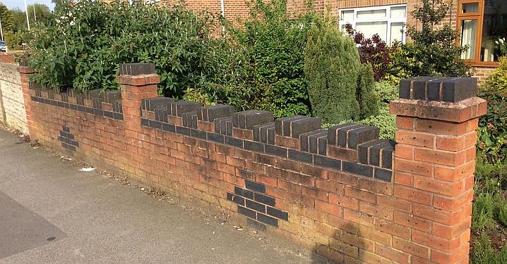

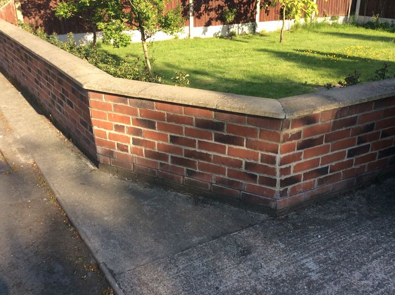

A Nice looking wall, made with facing bricks (like my house) and copers, and basic engineering bricks as DPC.

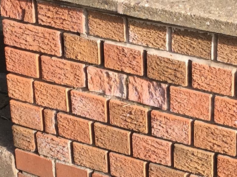

B But it has spalled badly. Do not use facing bricks for a garden wall.

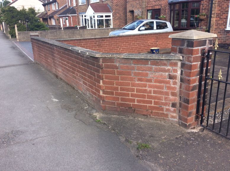

C I like this combination of red and blue. 40-50 years old and suffering a little? On the main road with the traffic.

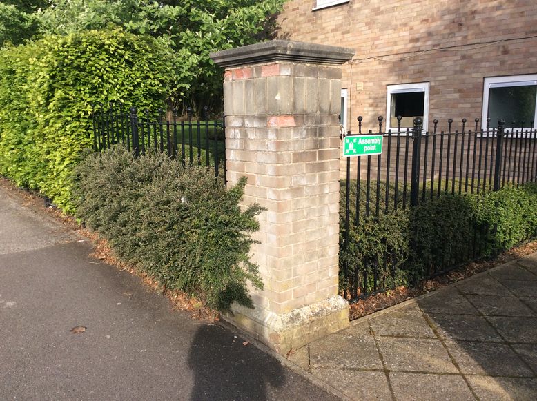

D Posh gatepost. Inadequate materials as used in the flats behind. Now badly deteriorated.

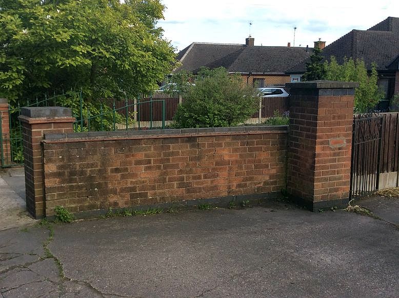

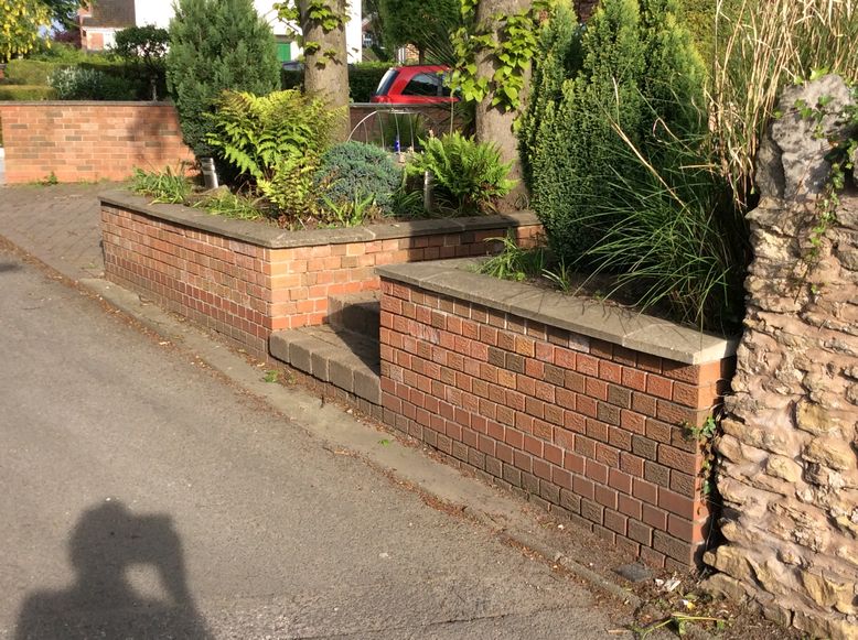

E Yep.Like it. Recent, and they have trees in the right place, too. But are those facers and will it spall later?

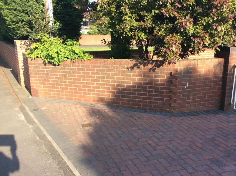

F As above, but two or three decades older and now careworn:

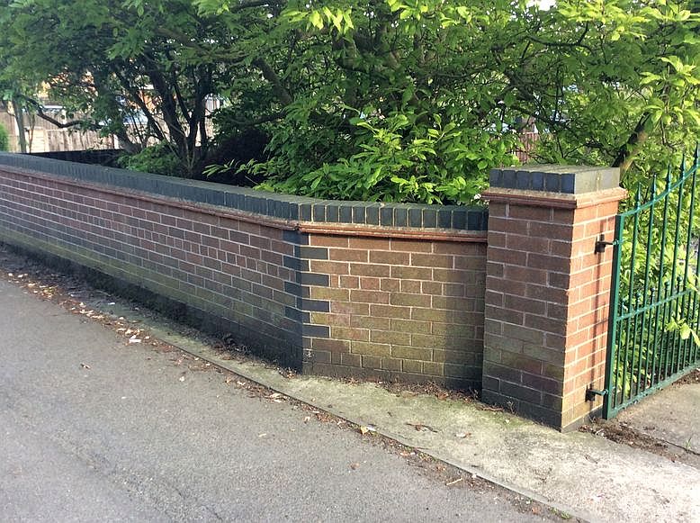

G Similar with added decoration from blue engineering bricks. English Garden Wall Bond, I think.
H Again, with blue decoration included in the paving:
I Another variation. Someone did not like the postbox in the gatepost.

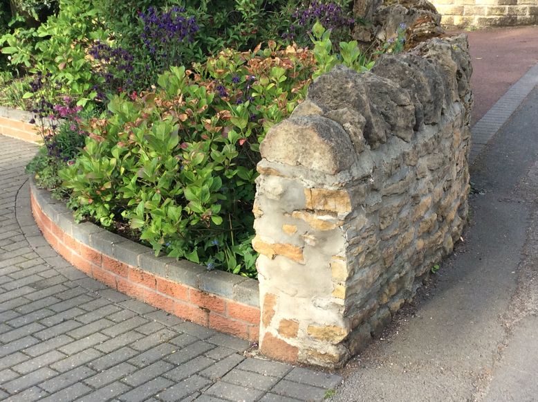

J A very carefully done piece of architecture imo. That stone wall style used to be the dominant note on the road, and is still the background.

If you want it to last, build the whole lot out of engineering bricks, a mix of red and blue to get your desired pattern.  Unlike a house wall, a garden wall will remain damp for long periods, and the frost gets in to a normal facing brick and you see the results.  Same applies for cement render to a garden wall, seldom lasts long for the same reason. Engineering bricks tend not to absorb water so less likely to fail.
I like the English garden wall bond one with a row of soldiers on top, rather than concrete capings.

Why not investigate a dry stone wall  just a short jump from pic J, perhaps expensive but the rocks will last forever, building it will be very therapeutic, no cement so other then the digger diesel getting it out and the lorry to haul it to you almost carbon zero and it can be repaired very simply.

Bricks come in various grades of durability & frost resistance. You'll need a F2/S2 grade brick which is the most frost resistant and lowest salts content (they are sometimes referred to by the old F/L classification)

Engineerings or similar hard fired brick at the bottom is always good,as is a tile creasing to throw rainwater off the face if not using coping.
Youre right about Eng Gard Wall bond but the brickie broke a cardinal rule-change direction,change bond!
I.e the header course on the sides should be 2 courses down & up from the header course on the long side.

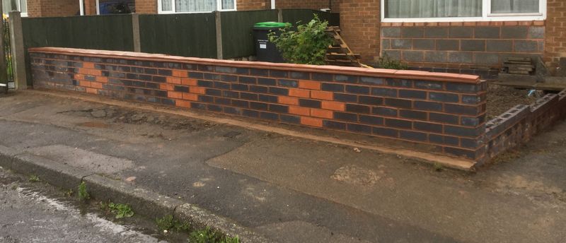

Decision made. I am going all blue engineering brick, with a double row of red tiles to be a dripguard at the top.
I will probably have a couple of details - say diamonds - using a small number of the bricks I have in honey-cream matching the house.

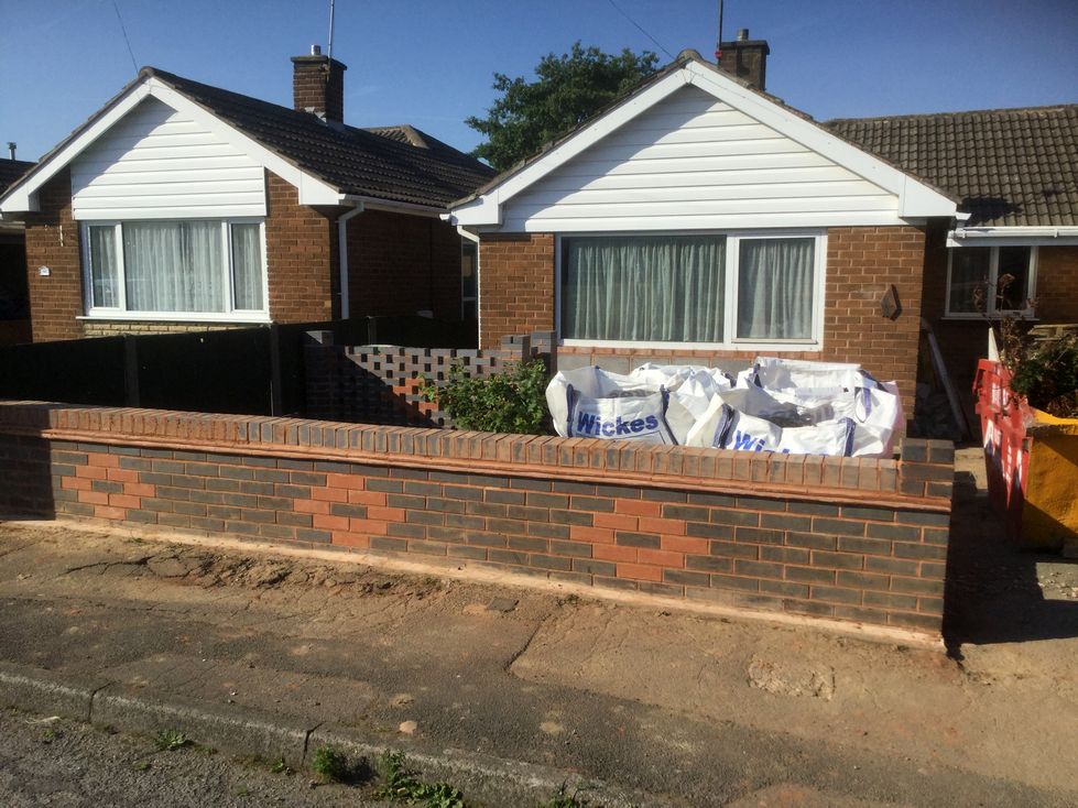

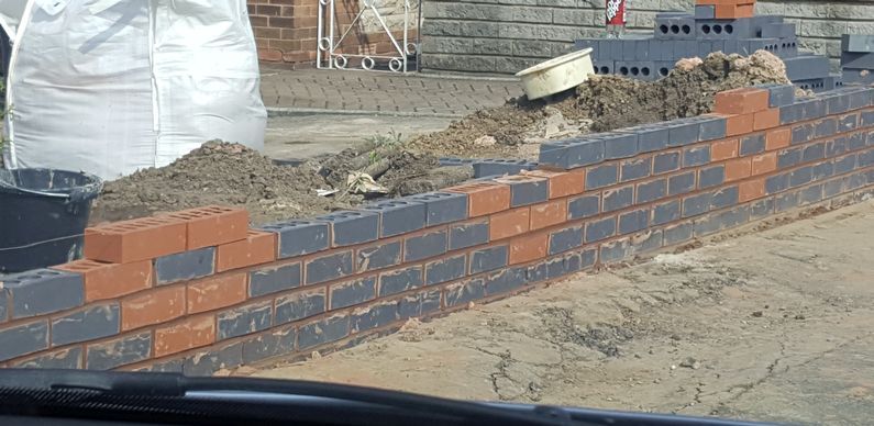

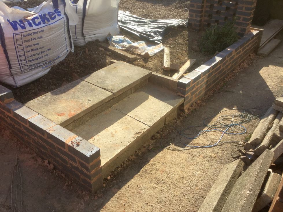

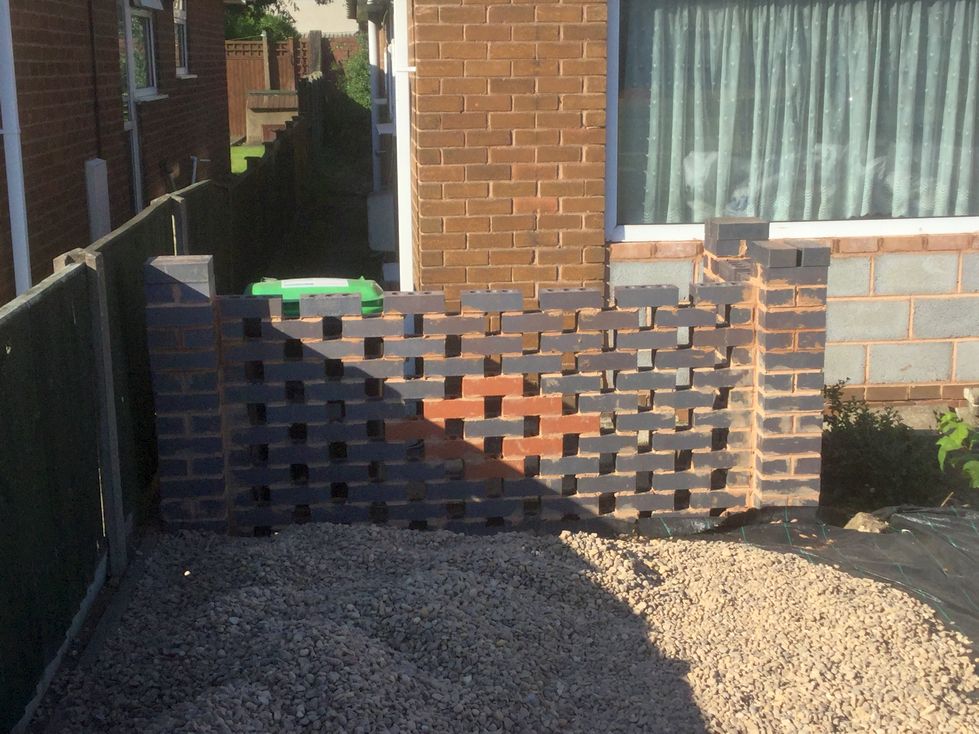

Progress. Looking good.
Up to the tile course. One row of Brick On Edge to be added, with three small end/middle pillars and blue solid bricks for the caps, then cleaned down with brick acid.
The dustbin area you can see will be screened by a blue brick perforated wall with tile capping this week.

We are nearly finished,
The garden wall just needs a little more brick acid and wire brush treatment.
The dustbin shelter needs one more course then a top of tiles and a tidy up.
And one of a bit more of the hard landscaping.
