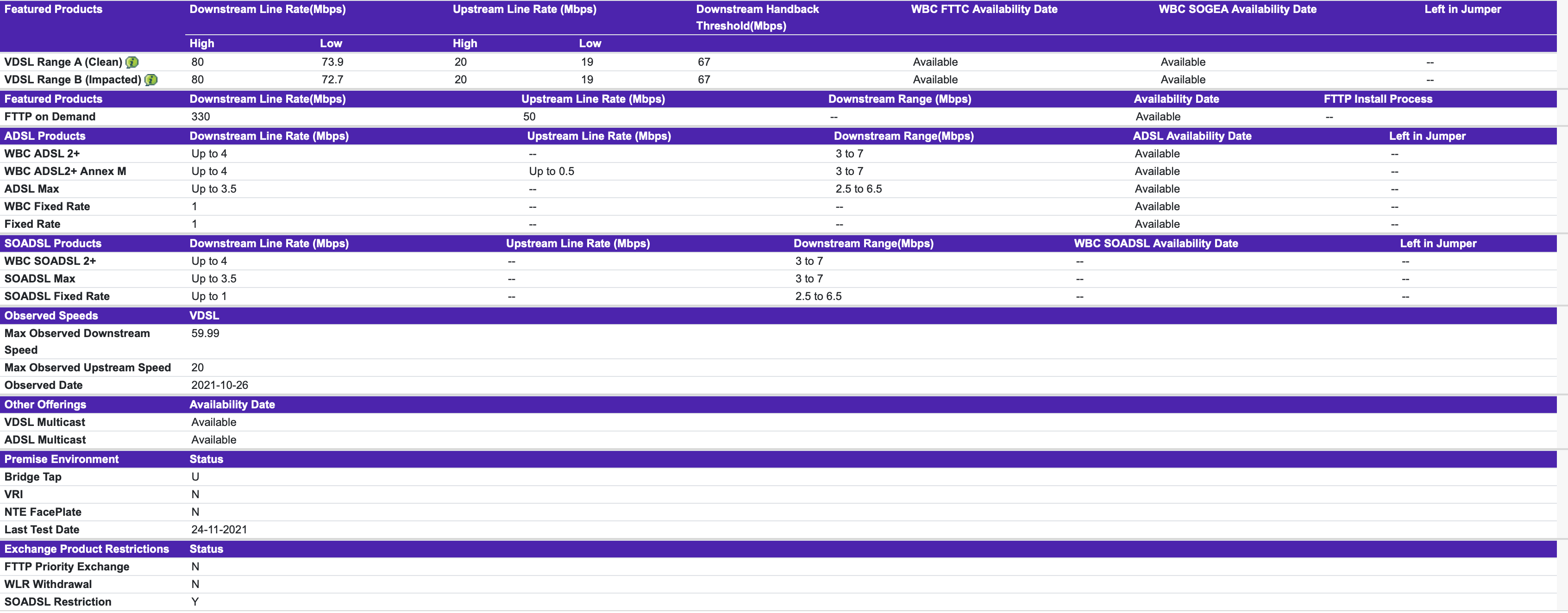

18 minutes ago, Dan F said:
Openreach send you to a FoD provider if the availability checker doesn't should FTTP availability.  In your case did/does availability checker show FTTP?
https://www.broadbandchecker.btwholesale.com/#/ADSL
yep! 🙂
1355083926_Screenshot2021-12-03at21_59_22.thumb.png.82b6029ced561e91affb01703db63041.png
but I never knew this checker existed. I found out when an OR engineer was working on the pole and I went out and had a chat and he said it was FTTP. so when I spoke to them about the new connection for our new house it was fibre all the way. I originally wanted the connection to go under the road as I didn't want wires overhead. the surveyor said that's fine but it'll cost quite a bit with the road closure, digging of the road, running the cable etc or they could put the pole up and it'll be free. wasn't a hard choice.
Share this post
Link to post
Share on other sites
@Thorfun That's same as me.  In theory that means that FTTP is not available to purchase and you need FoD which generally always has a built-out cost.
If FTTP is available it says "WBC FTTP" and the bt broadband site (https://www.bt.com/exp/broadband) will offer a fast connection.
I'm intrigiued now as to how you have a arranged a free FTTP install via OR when checker shows FTTPoD.
Edited by Dan F
