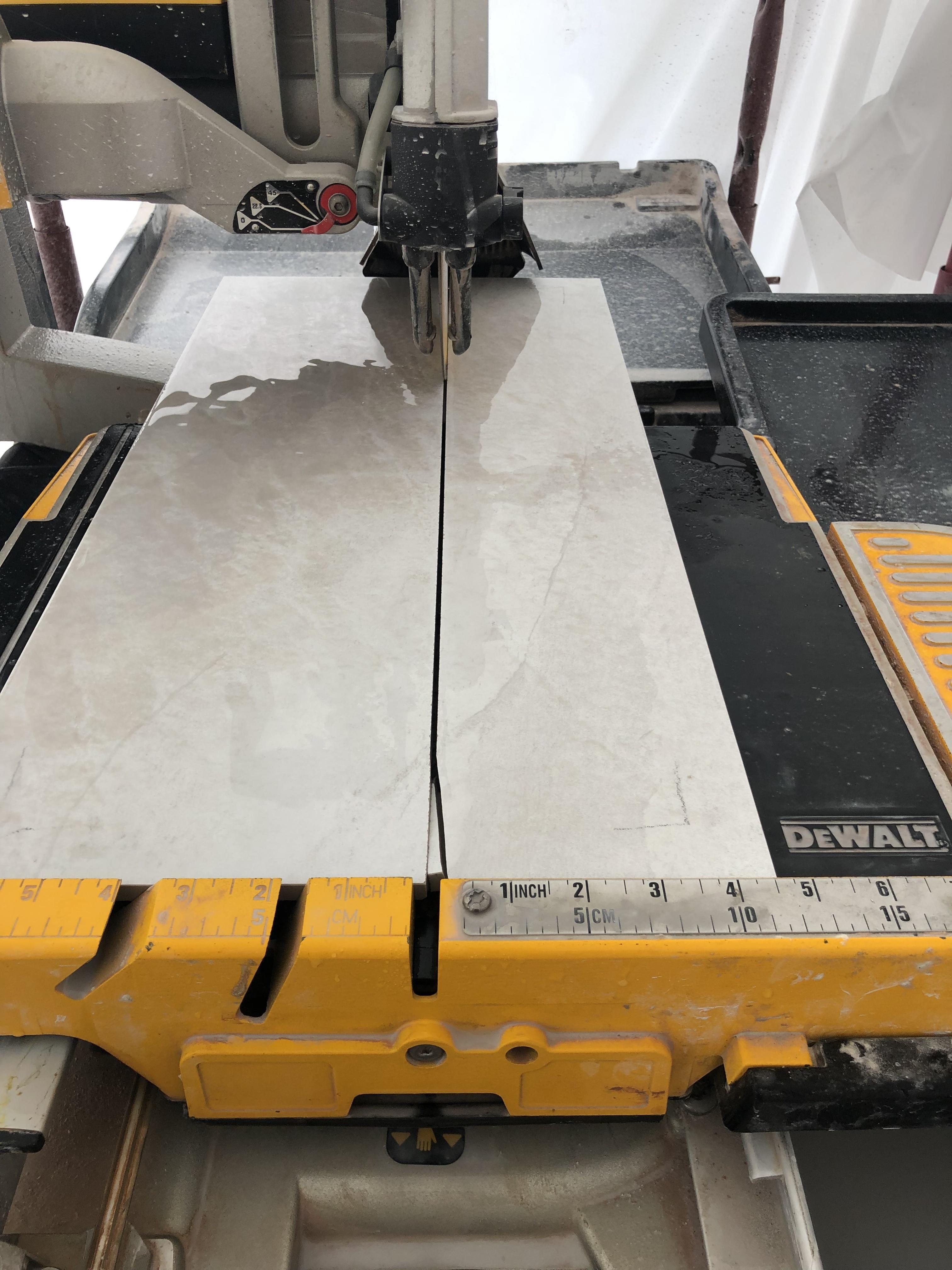

The beast has suddenly decided to crack quite a few tiles right at the end .
I try holding one side or the other when putting the tile through the blade - seems to make no difference. Platform and blade seem level . Any suggestions??

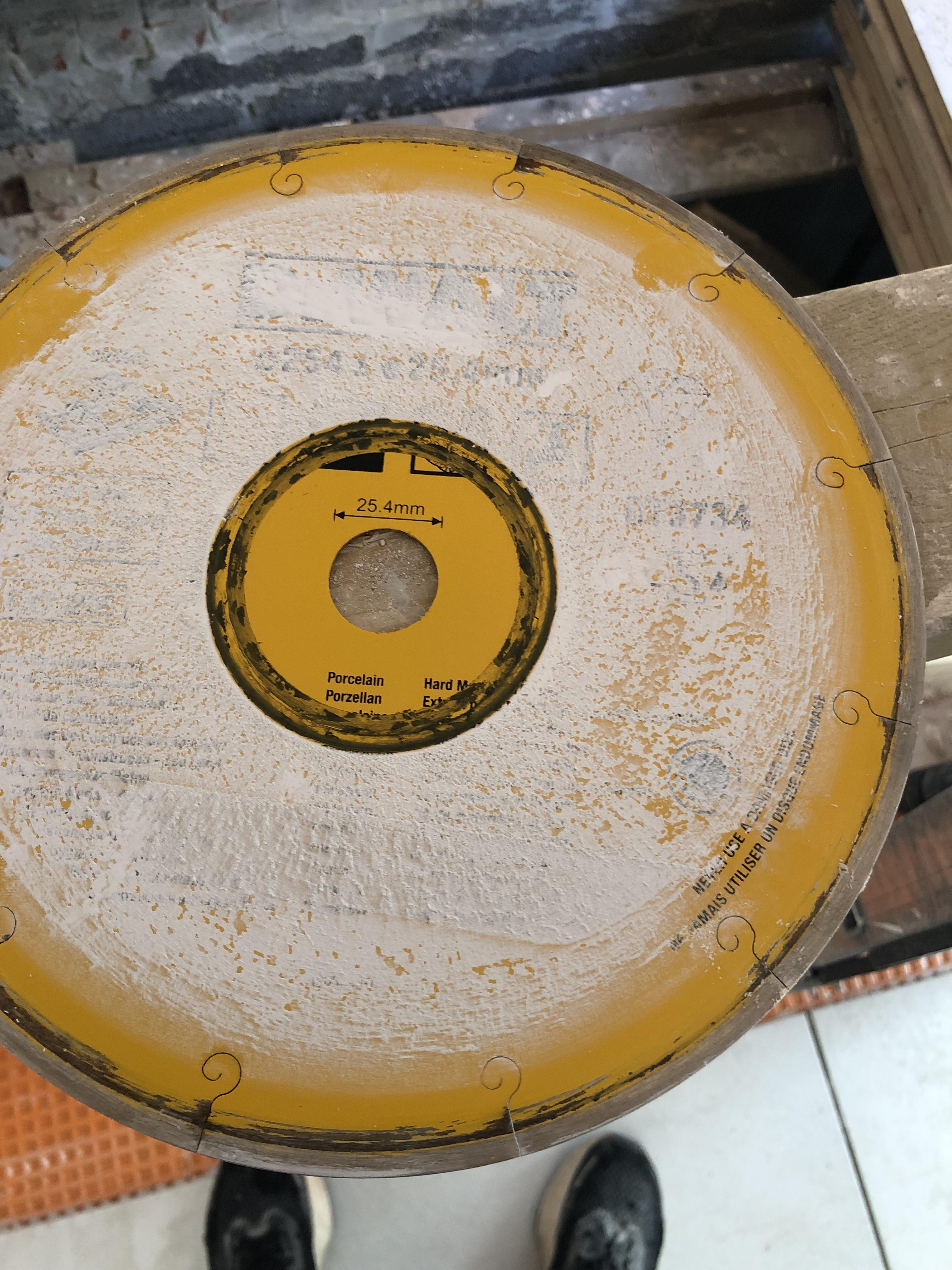

Hmmmmm
I’m not sure what’s going on here .
The tile lifts slightly at the end where I push it in . Like the cutter is pushing down on the tile too hard . I would of normally thought a blunt blade ; but changed this blade a few months ago . A Dewalt blade so not cheap . Perhaps a different blade ??? Any suggestions ???

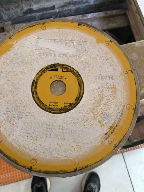

Guess you can’t tell visually if a blades blunt . The edges certainly feel exceptionally smooth !!!
50 quid a pop these Dewalt blades !!

That photo with my feet make it look like a giga size blade !!

If the tiles are hard it will wear the diamonds down. Get a softish house brick and dress it across the spinning blade, this will pull the adhesive from the blade and expose fresh diamonds.

Bought a new Dewalt blade - didn’t gawk too much at the cost now I’ve seen the price range for such things . Cutting much faster and smoother now 👍
It seems to me that something is going out of true towards the end and rather than the blade cutting through it is putting a load onto the tile which is cracking it.
It stands to reason that a good blade spinning fast will remove material thus cutting through, if this remains straight, level and true then the blade will continue on it's path, if at some point something tilts or turns or rocks, I could see the above occuring.
I had an issue with vibration, once the tile was nearly cut, the last bit was just cracking off - I ended up needing to get the tile to sit more firmly so it couldn't vibrate the backs of them their quite rough so sitting flat and firm was not an inherent characteristic of the tile.
I would perhaps get some scrap tiles (looks like you may have a few!) and investigate how square everything sits in relation to each other particularly at the last section of the cut. If the issue is limited to the last 50-60mm then could you try cutting it with a wooden spacer to move the tile out further, if that cuts no issue then you know that something is happening at the final stroke.
Is the blade running dead straight the whole way? It is not by any chance taking a lean at the last section due to a loose rail or bearing or bent bit?

Checked it all . As my first thought was wobbly tray or mis aligned blade . All seems solid too me …. Will try your idea of pushing the tile out from the tray for the final cut
