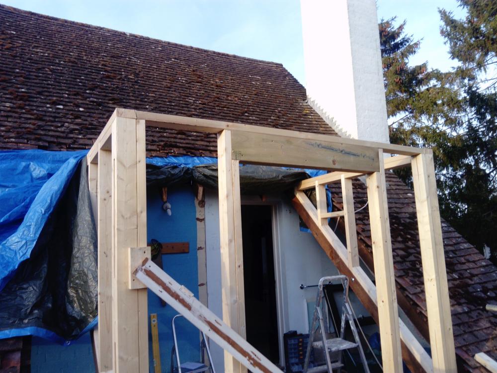

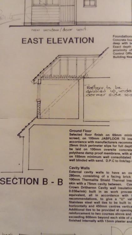

1, Do I put the new rafters on the inside or outside of the rafters that the cheeks will sit on?
2, The new rafters are 6m long ( so I'm having to join two pieces to make 6m,) so...at what interval do I bolt the new to the old?

No, you will have to build the dormer cheeks on the same line as the spars otherwise you will have a step on the inside. The stoothing for the cheeks will sit on both spars anyhow because of the width, even if only using 50 x 75 which would be the absolute minimum.

The original rafters are 50 x 125 and the new ones are the same so the cheeks (made from 50x100 studs) will rest on those... What should the cheeks be built of.?

So my rafters are doubled up under the dormer cheeks and it's M12 bolt @600mm spacing up the middle of the rafter with square plate washers either side and a spiked washer between the rafters.
That makes them 95x175 so they are going nowhere ..!!

Just as an aside, I don't know what you're cladding the dormer cheeks with (lead or tile hung or other) but if you simply nail another piece of timber to your outside spar you will have something to nail the main roof tile lath into where it butts up against the dormer. Yes it will carry without but it's a better job with.

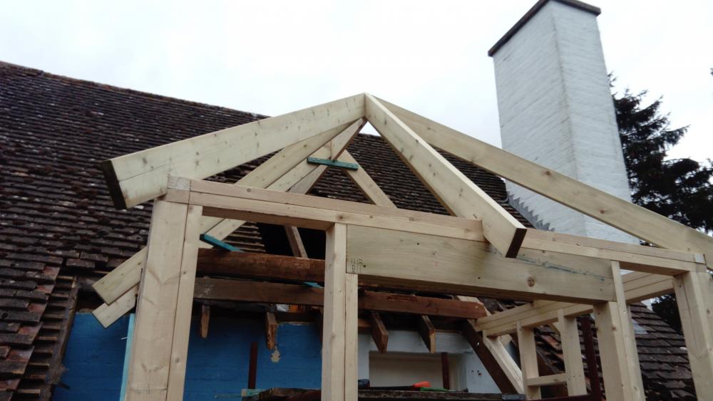

What size should the ridge timber be?
I have 50 x 250mm
I'm assuming you mean the ridge board as opposed to a ridge beam.
If it's only a ridge board 50 x 250 is way overkill, with 50 x 125 rafters I would use more like 25 x 200.

A ridge board isn't load / weight bearing.
A ridge beam is.
If your making a 'cut' dormer then your looking at triangles, with the bottom horizontal timber being your ceiling rafter.
If that's the case, and they're not vaulted, then you don't need a ridge beam ;)

As above, with a cut roof and 50 x 125 rafters I would use a 25 x 200 ridge board.
As Nick explained better than me the ridge in this situation is not structural. The roof gets it's strength from the triangulation of rafters / ceiling joists etc all being nailed together. This stops any spread loading on the wall plates (even though it's only a dormer).

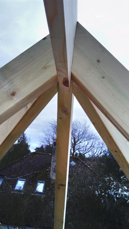

Part vaulted? Er, if by that you mean there will be rafter ties up in the apex rather than at ceiling height.... The former is my preference but do I have the option?

@Dee i presume one of you knows how to work out the true lengths, plumb and seat cuts? this, https://prezi.com/qnjmw9dbfnic/traditional-cut-roof-geometry/ may help, we don't use saddle boards, just the crown rafter which is the same as a common, the compound cuts of the jacks/cripples are fun.
