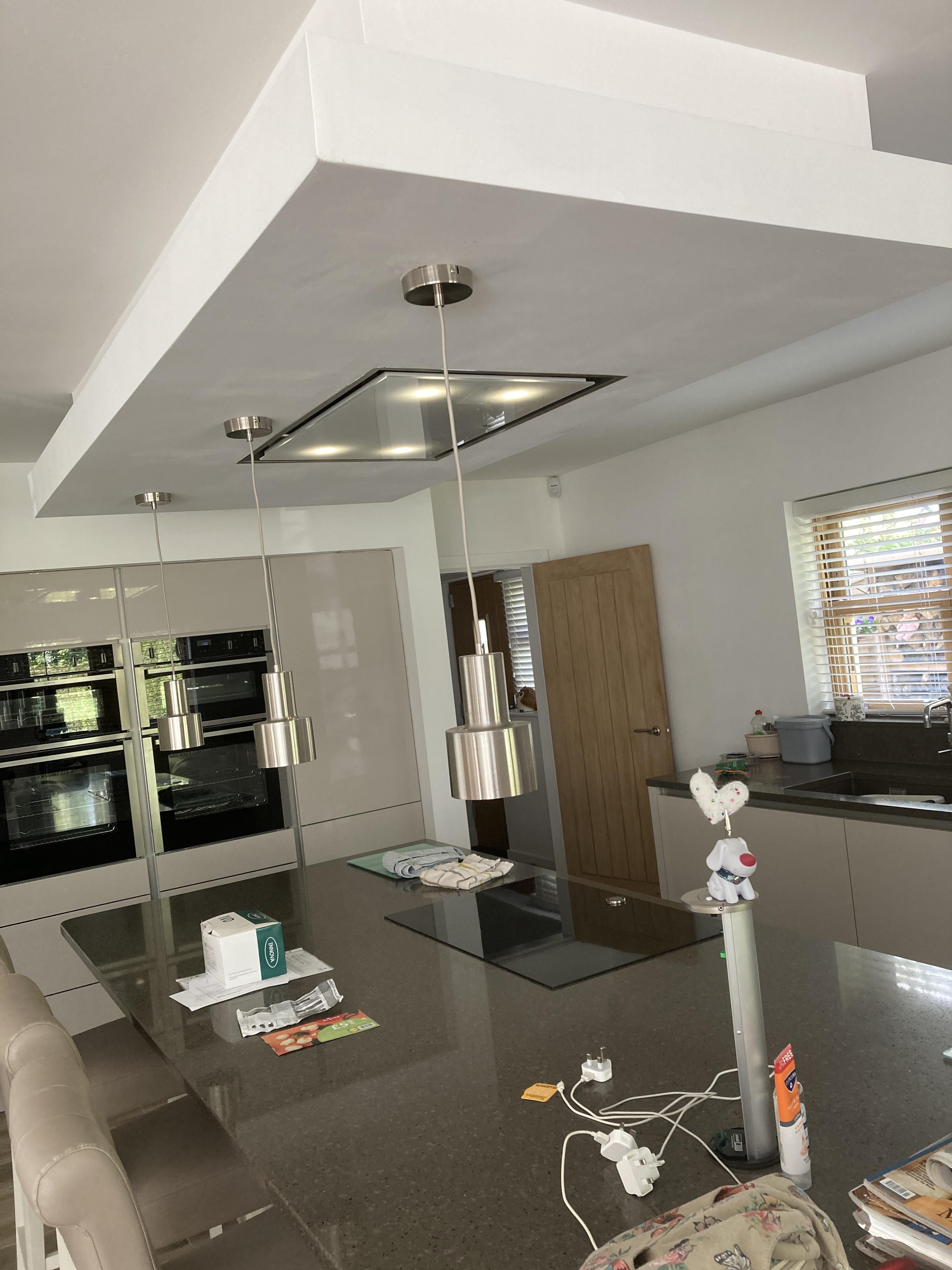

Coffeepotclaire Posted May 2, 2021 Share Posted May 2, 2021 Hi all, Some of you may remember me pestering you all for advice on best extraction on a island with 3m high ceilings. Well, we've now decided after much deliberation to now place our hob on an outside wall with a canopy type hood (is that what you call it when it's built in to your overhead units?) Can anyone please recommend some really good makes please for this type of extraction? I obviously need it to be powerful as I do a lot of smelly cooking but not too noisy (if that's at all possible). There are so many on the market, its so confusing so would really appreciate some guidance. Also, we would be looking to duct out through either the outside wall or out through our flat roof. If we duct out through the wall, it would be very close to our neighbours property and I wonder whether there is any laws against this? 1 Link to comment Share on other sites More sharing options...
