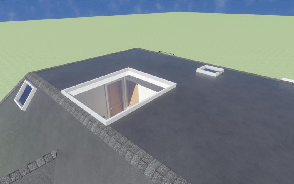

Flat roof considerations: Safety, Rain and Shine
So two semi-separate issues but.
Current design:
<inside>
15mm Plaster Board
i Joist
18 mm OSB
Vapour Barrier
Insulation 200mm
18mm OSB
GRP
<outside>
My 2 questions:
1/ Safety: without railings the roof is somewhat dangerous for anyone under 18yo. (and I have a 3yo). Of course, securing the access stair/rooflight should be fairly doable incl alarmed etc, but I was wondering: I have to stick to ridge height as per planning permissions. Are handrails/balusters acceptable anyway, or do they count towards the ridge height?
2/ Slightly slanted GRP. So as above I'd like people to be able to walk on the top floor but would that be a problem? And can we slant the roof somehow to prevent rain from staying?
Current design: (big skylight is all the way to ground floor, the small skylight doubles as access to the roof

I would not bother with safety.  If you include handrail it will need to be fully safety compliant.  Planning would not want it used as a roof terrace / observation deck.
The roof needs a fall of min 1:60 preferable 1:40 which is normally achieved with timber firrings.  You can have it so it falls in 4 directions like the pitched roof.  This will be good for the skylight as it will let it drain.

If you're only using it for cleaning access then just providing a secure fixing point near to the access is enough - you'd then use a "fall restraint" system (basically a rope too short to let you reach the edge) and no further safety provision is required.
If you want to use it as a roof terrace you need a properly engineered system of barriers - nobody is going to believe a claim about using fall restraint for that - and then you need full planning, building control, etc.

A balcony is an external area that is intended for domestic use and designed for that purpose. It needs to be approved by planning and conform to building regs.
A roof is not intended to be accessed in any way or walked upon apart from people who have the necessary experience of working at height , insurance etc and are there for some kind of essential purpose (e.g. a roofer). They should have external means to access the roof (ladders, platforms etc) , you could provide access from inside but ask yourself how often that will be needed and do you want a messy trade getting your interior, ceiling etc grubby?
If you open your roof 'to the public', including your family, then you'd be in contravention of your planning permission (overlooking neighbours etc) and you'd be legally liable for any falls or worse.
Can't think why a properly constructed roof will need access for maintenance. If keeping the window clean is your concern, may be cheaper to spec a self cleaning glass for the roof light and let the rain do the job for you.

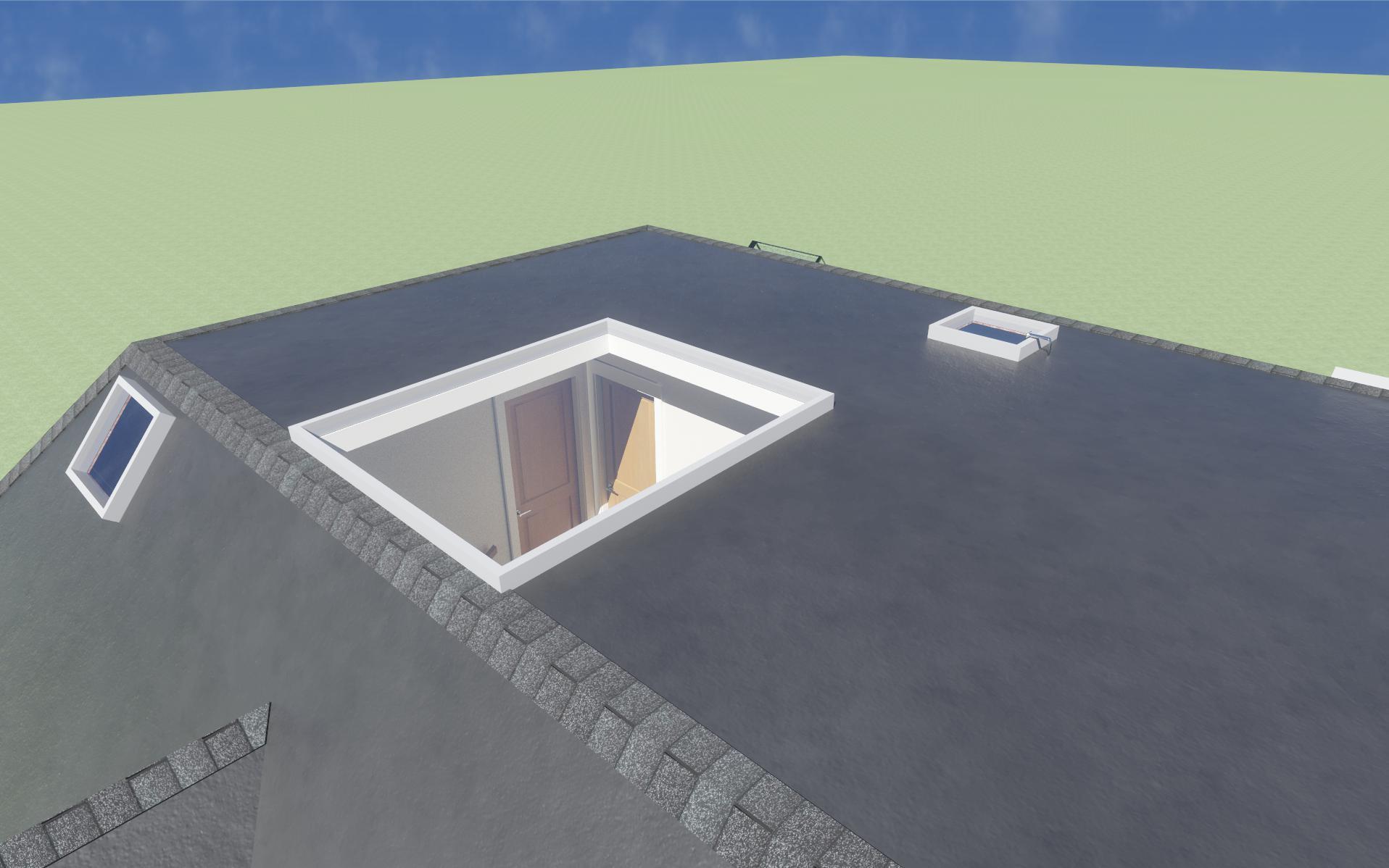

Also what's your shading strategy for that large skylight and can it be opened to facilitate stack ventilation?
Share this post
Link to post
Share on other sites
Good question and my answer is only half-baked (not checked against 'reality')..  I was planning to allow it to open, and I put in electrochromic ('smart glass') in this direction: https://www.iqglassuk.com/products/invisio-thermally-broken-rooflight/s53537/
Do you have any suggestions? 😃
Share this post
Link to post
I only have experience with Velux Integra windows, which I have been very happy with. Velux sell external motorised blinds that run off the same controller.
Only drawback for you is that Velux have a min 15o roof pitch requirement, however that could work in your favour as it would address any drainage issues and other potential problems that come with completely flat roofs. @jack had leak issues but did not use GRP.
We have two flat roof sections, each about 3m x 2m. One has peeling top coat which has been replaced once (and peeled again) and the other does not have enough fall so has a permanent puddle on it. No leak issues though.

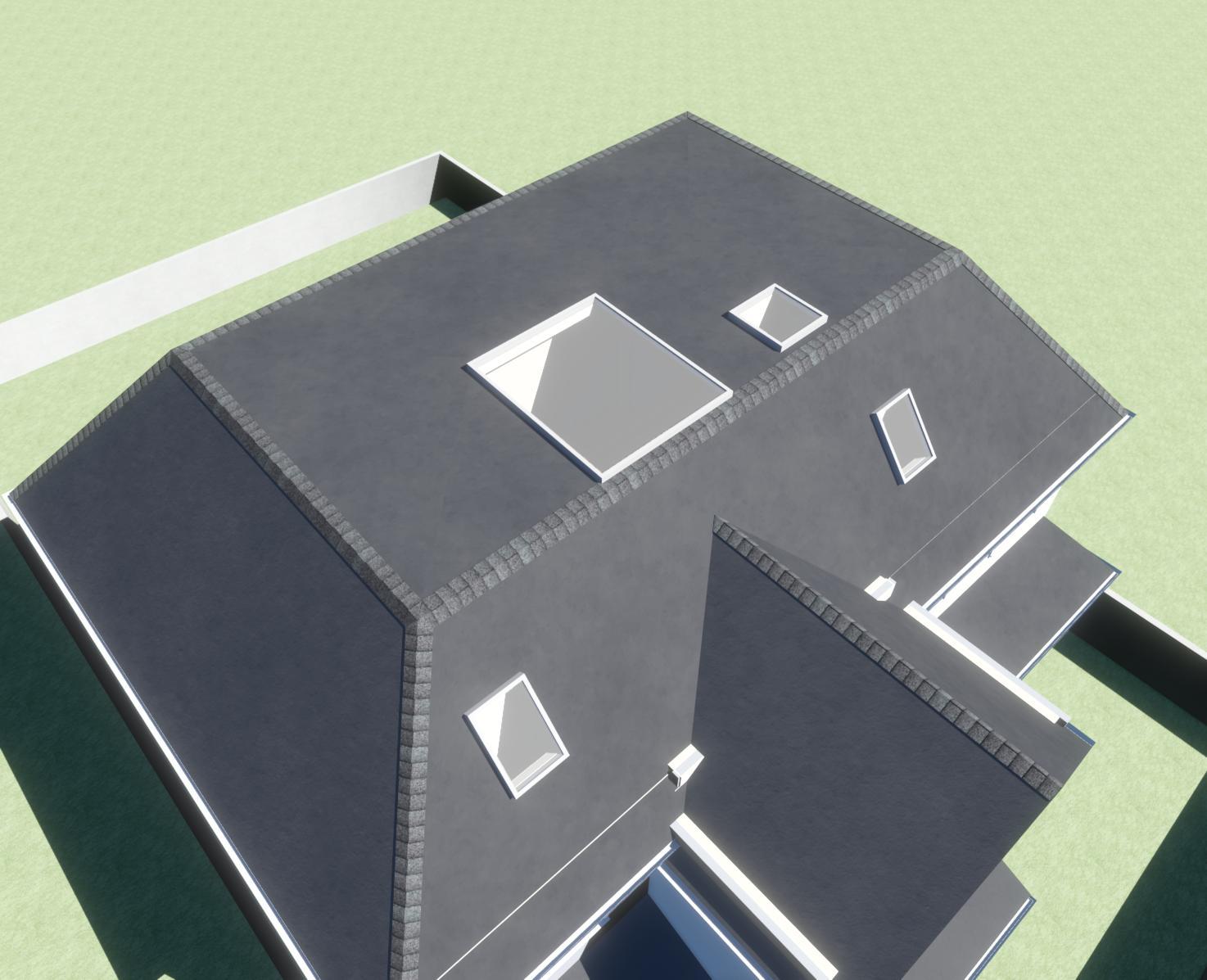

Our entire roof is flat (well, flat-ish - most of it actually has a 5° slope, which is better than 1:20). We were advised that fiberglass would be difficult over such a large area due to thermal expansion issues, although I've since learned that this likely wouldn't have been the problem it was made out to be.
The leaks happened where the Resitrix membrane joined scuppers passing through the parapet wall. We have five scuppers, and three of them failed (one failure only became apparent when the scupper was removed).
Our Fakro rooflight is built on an upstand and nothing in that area has ever leaked.

we do have 100% flat roof (slight pitch for water run off purposes) with roof lights. One is an access hatch so we can access the roof to clear off leaves. We have a high-ish parapet at the edge but I wouldn’t go up there if not for leaf clearing. Not cleaned the roof lights in 2 years. Seem ok (no self cleaning glass here).
solar heating is an issue and we had an external film applied last year so we’ll see if that helps this summer
as @Bitpipe notes we had a leak (I did a blog entry I think). Roof membrane was not the problem. Poor window design and installation was. Now resolved. Thankfully.

'worried' is the wrong word, I don't think there's anything structurally harder than normal (pitched or normal walls) but I'd note that typically there are 2 issues with use of such:
1/ cleaning tends to be harder - and self-cleaning glass apparently is expensive but I haven't actually seen any quotes yet - does anyone know a rough ballpark for triple-glazed-but-standard vs triple-glazed-plus-selfcleaning per sqm?
2/ Hard to fight solar gain. So, perhaps you'd want triple-glazed-with-builtin-shutter-and-selfcleaning (which of course is GBP 20,000 per sqm or something.. happy to hear more accurate estimates ;) )

I would reduce the size of the rooflight as you will end up with lots of unwanted solar gain at the top of the house.
I have had a Velux with a curb electrically operated in a stairwell and that worked well.  You do not need to go outside to clean them as they flip round to give you access internally.  They do electric blinds and external shutters as well.  I think most of their electric stuff can be solar powered if you want to retrofit the functionality but have no run the power.
Velux also do a flat roof rooflight without a curb but they don't seem quite as good.
