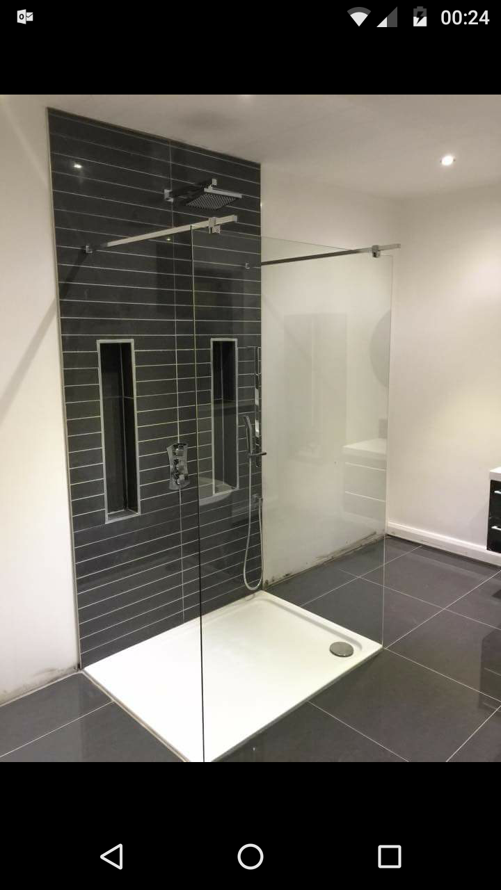

Lay the bottom tile first, then the top, fit the back then the sides.
As @Nickfromwales says if you can keep the water out even better, I tend to use a bead of sealant such as CT1 behind the bed joints so no water can get in.
The usual problem area is the trim on the edge as water can pool on the grout if you're not careful.

Makes no difference whatsoever because you'll be tanking it ;)
1 hour ago, Onoff said:
I'm using these large format mosaics (SWMBO chose) so the grouting it limited:
Again not much difference as the point of failure will be between the tiles at the corners, and more so against the trims, where they meet the tiles, where it's a pita to get a decent amount of grout in.
Getting a foundation of CT1 in behind these points is where the money shot is ;). E.g. Tiles bedded into wet CT1, then grouted or colour matched silicone in the grout lines ( as is in that pic I posted with the 'corner' shower ).

23 minutes ago, bassanclan said:
What about using expoxy grout?
It is a lot more or a pain than normal grout to fit, but is bloody good and will last and be waterproof.
I have used mapei Kerapoxy before and been very happy
Never used an epoxy grout TBH. Proof again that many heads are better than one :)
My concerns are where the trims meet tile and grout as there is little or no purchase against the metal or plastic imo. The issue is amplified when using timber frame as it expands and contracts a lot compared to brick / blockwork installs.

1 hour ago, JSHarris said:
Not sure what Nick has used, but I used some high modulus, neutral cure, silicone to stick some difficult tiles to plywood a few years ago, and found it was easy to do, worked well and lasted for several years
Exactly what i use on all boxing in and bath panelling etc. Sticks like shoot to a blanket and never lost a patient.
Unlike what i have found when tile adhesive ( especially the ready mixed crap in a tub :( ) has been used and I've been called in to regrout it, and worse, redo it all where the grout has failed and water has pulled through and rotted all the wood from the inside out. Looks great until the day it all just turns to mulch and falls apart. By then the floor has usually gone too.
Belt n braces folks ;). ?
