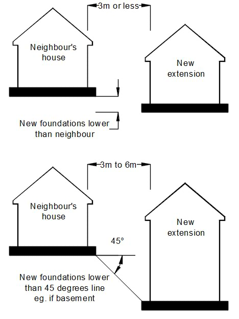

I thought I need to get a party wall agreement because the basement and piling for foundations were going to be lower than my neighbours, but perhaps not then. I'll have a chat with the architect to see where we are regarding the BC drawings.

We went through this with our basement, provided you are more than 6m from your neighbours foundation and don't fall foul of the 45o rule then you won't need a party wall agreement.

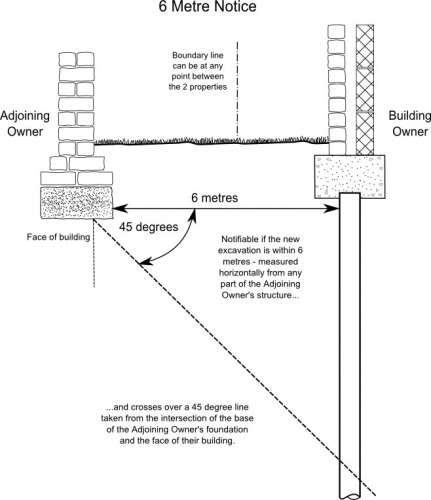

Thanks Bitpipe - Seems like I'll need to get a PWA then, looking at the diagram we're closer than 6m on one side.
It does not matter if you are within 6 metres UNLESS your foundation / walls cut through the imaginary 45 degree line.  Unlikely unless you are piling or within 3 metres of their building.
Party Wall matters can be expensive and time consuming, so if you do not have to do it, don't.

Completely agree - do all you can to avoid it. Here's the more complete view.
