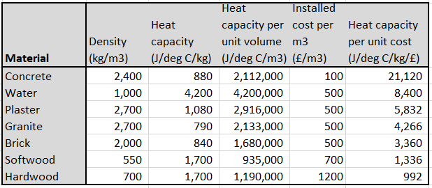

reddal Posted May 21, 2016 Share Posted May 21, 2016 On 20/05/2016 at 16:08, JSHarris said: So, if you want to create a house with the highest "thermal mass" (i.e. Heat capacity per unit mass, if that's a reasonable way of trying to define this unknown term), then here is a list of materials, with the highest heat capacity for 1 kg at the top, and lowest at the bottom: Water Wood Plaster or plasterboard Concrete Brick Granite You may well spot a few odd things here. The first is that you cannot build a house with water (but you can include water as a heat distribution or storage system). The second is that concrete, brick and stone aren't great materials in terms of storing heat for a given mass. Surprising, isn't it? Even more so when building professionals keep harping on about the virtues of so-called "thermal mass". Hi, I agree with your point about the term 'Thermal mass' being much misunderstood and misused. Its interesting to think about alternative measures of how good a material is at providing heat capacity. i.e. instead of Heat capacity per unit mass - we could look at Heat capacity per unit volume. I think ordering by that would give : So wood does worse under this measure and concrete/granite a little better. We can go further and estimate the cost of installing a m3 of each material (installing a m3 of water is going to involve tanks or pipes etc so isn't cheap!). I made up some numbers for the costs - which may be off - then used these to calculate the Heat capacity per unit cost. Ordering by that gives : So in terms of heat capacity per £ spent - Concrete is the winner by a distance - and wood is very bad. Maybe my estimates and/or calculations are wrong? So we have 3 different measures - each of which captures a different aspect of what people mean when they say 'thermal mass' : Heat capacity per unit mass Heat capacity per unit volume Heat capacity per unit cost Different materials look better or worse depending on which measure you use. Not sure if that is useful or just adds to the confusion - I just thought it was interesting :). - reddal Link to comment Share on other sites More sharing options...
Jeremy Harris Posted May 21, 2016 Author Share Posted May 21, 2016 As I mentioned above, though, heat capacity on its own isn't a great deal of help, unless the material is sufficiently thermally conductive to allow heat to transfer in and out of it at a rate that is consistent with being able to regulate the temperature of the interior of the house. This is one reason why the general rule of thumb on the impact of added heat capacity suggests that it is only the internal surface layer that has a really significant effect, and that anything that is deeper than around 100mm from the surface has almost no effect at all. What is clear is that if you have a house where the insulation is on the outside (which is generally a good thing in terms of increasing the thermal time constant) then that insulation not only has to be effective in terms of having a high thermal resistance, but it also has to have a relatively high heat capacity, as the combination of the two increases the decrement delay. Link to comment Share on other sites More sharing options...
