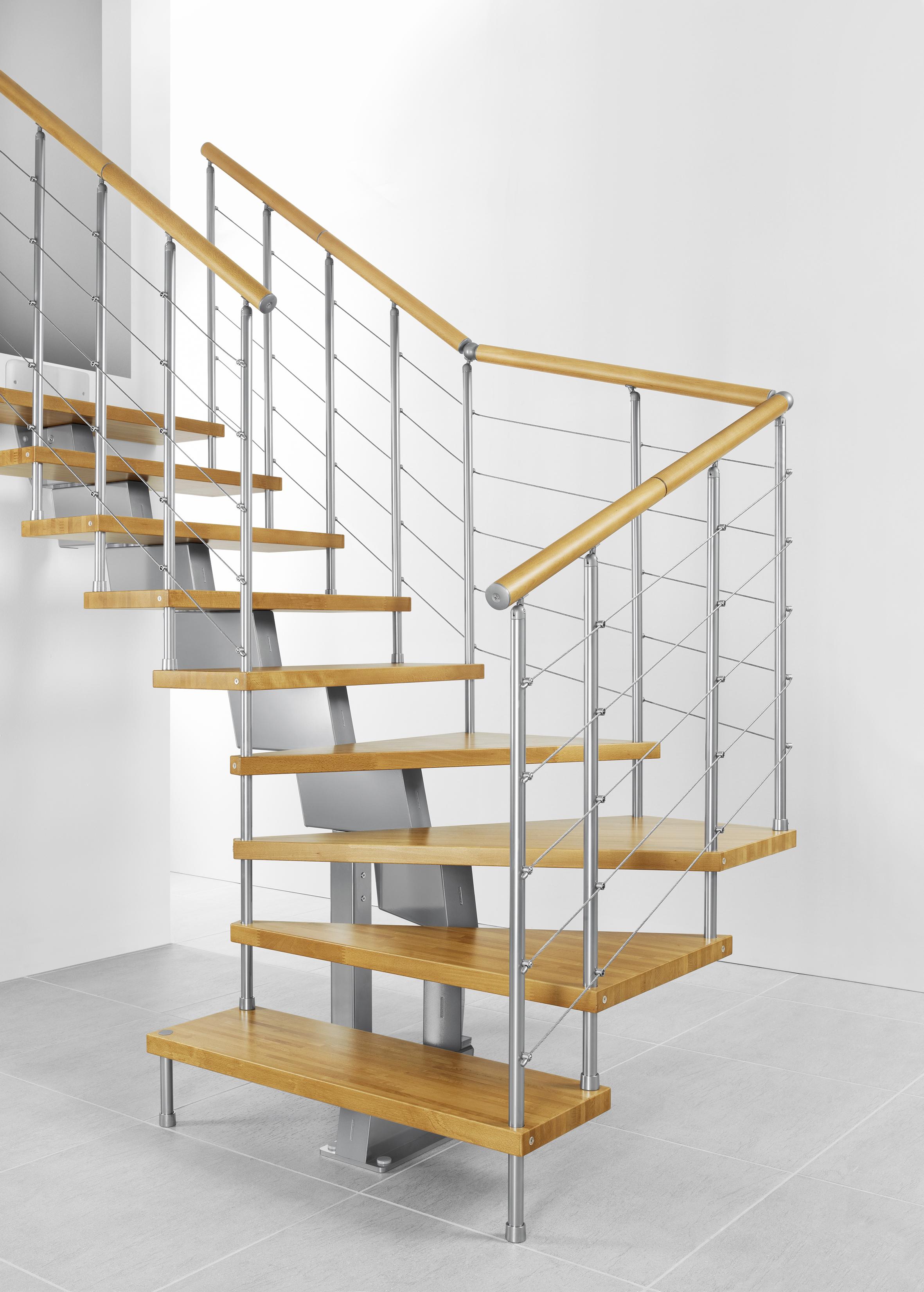

I am renovating a house in London and found this wonderful, stylish, Italian staircase. Made by Fontanot an Italian firm. I bought the staicase. The price was very reasoanable  (under £4,000) for two stories, but it is proving very difficult to install. Fontanot says that it can easily be fitted by a DIY specialist, but the buildres working on the site have not managed to figure it ou, inspite of instructions and videos. The company which sold it to me just insist it's easy to install and gave tme the name of one installer, right up north who is busy for two weeks
Surely there is somebody out there who can install it? I have a budget of £1,800 so please contact me if you know of anybody who can do it. I have instructions and videos

I don't know how to break it to you gently, but that staircase will not comply with UK building regs.
It will fail the "100mm sphere will not pass through" test between the treads, and between the (yacht rigging) banisters (because they will push apart).  It will also fail as horizontal banisters even if solid are not allowed any more as it's too easy to climb up them.
So you need to partly block the gap between the stairs, and fit a solid vertical banister with <100mm gaps.

Hi Fiona, I have replied to your message. Our Fontanot staircase meets all the UK requirements and the pictures are not specific to the UK. Did you visit the UK supplier in Rotherham to order the staircase?

Doesn't look rocket science but easy to say from here. What aspect are they struggling with? Connection to existing structure or assembly?
