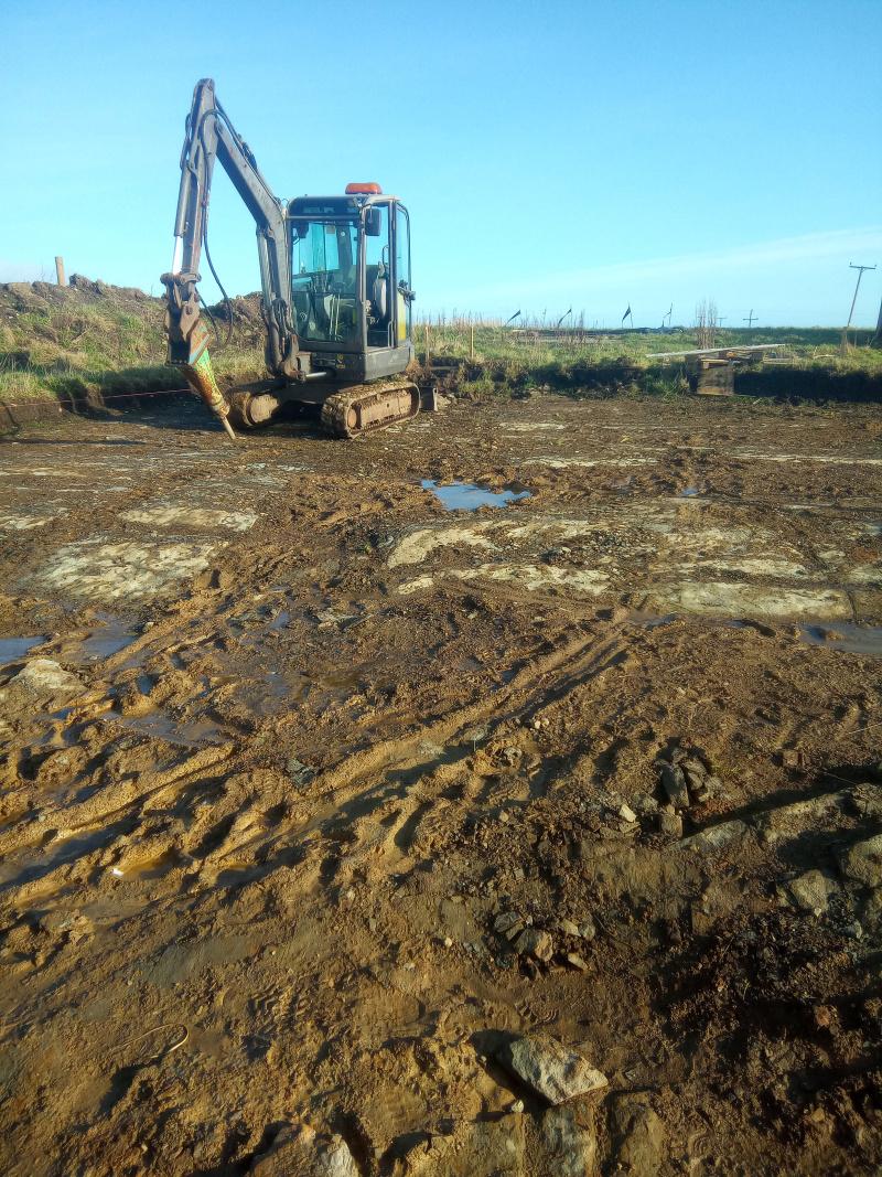

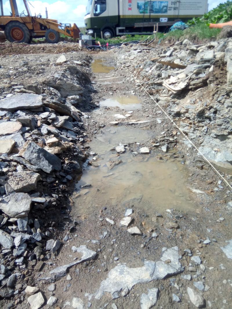

Back in February we hired a 360 with a pecker to break out some of the rock to lower the NE corner, as the bed rock slopes to the SW.

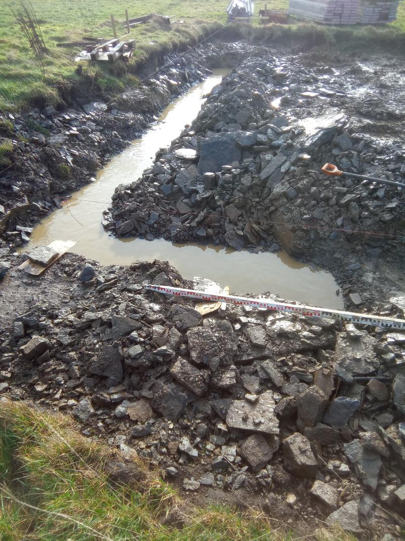

Bed rock exposed looking East
 NE corner
We broke out and removed around 400mm of rock along the W and N elevations, the break out got shallower towards the SW corner.
The main aim here was to reduce the height of the house on the SW corner, we will be bringing the ground level up to minimise the impact.  We also need to strip some rock of the slab area to allow for the 300mm insulation.

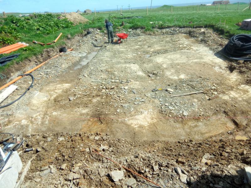

This week, thanks to an understanding BC officer, ( still waiting for the revised certificate of design to change the building warrant, but he's happy for me to proceed with the old warrant for the time being👍❤️). We made a start preparing.

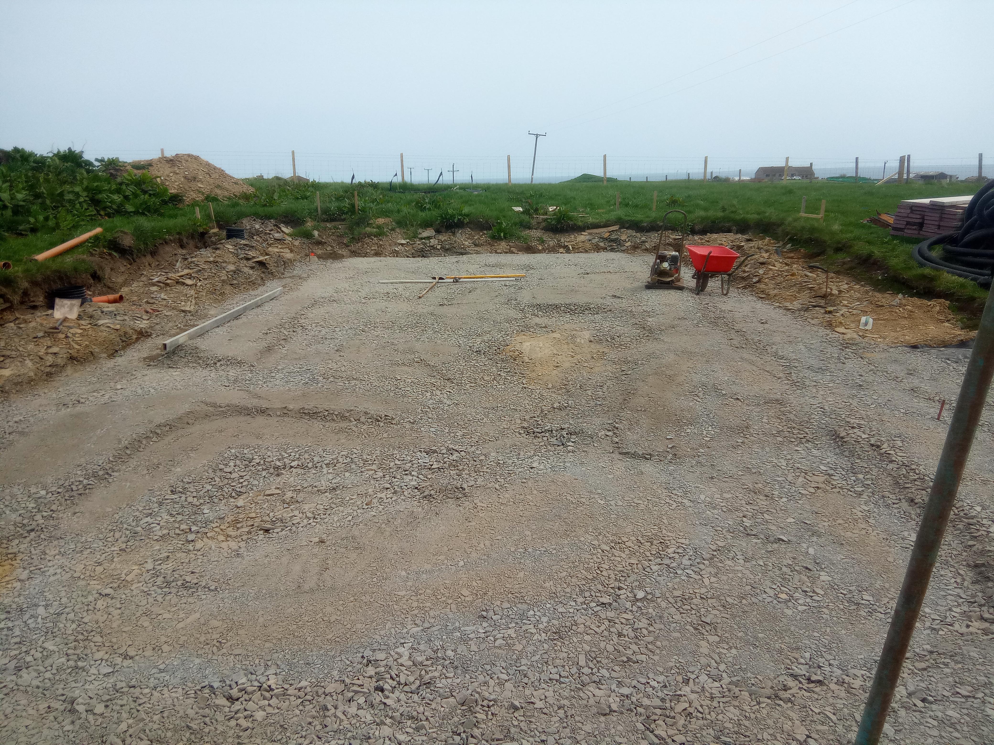

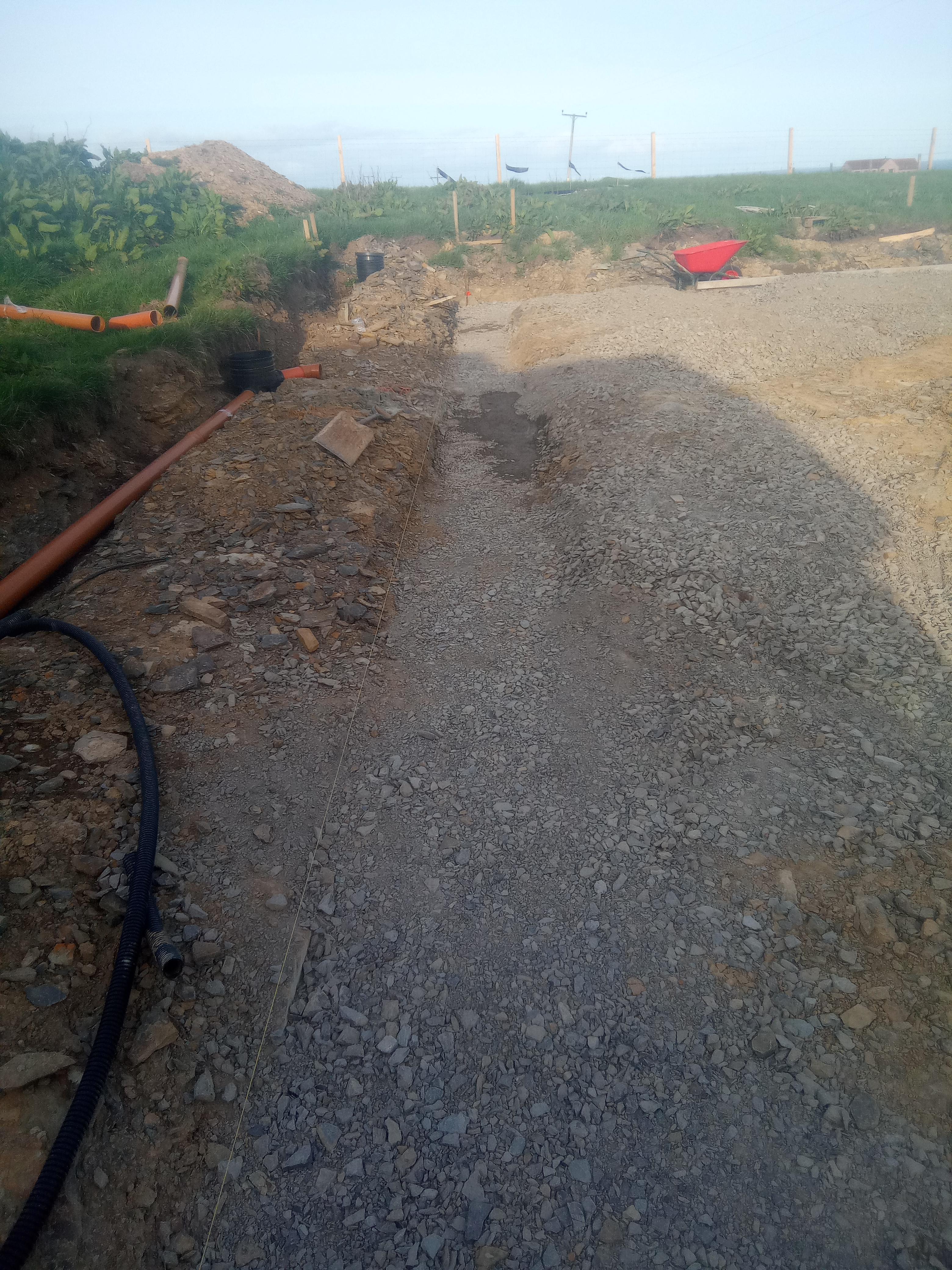

The plan is to shutter the strip foundation. First step was to level the strip with layers of compacted 40mm to dust stone, and also level the bedrock for the slab.
Ready for stone looking W

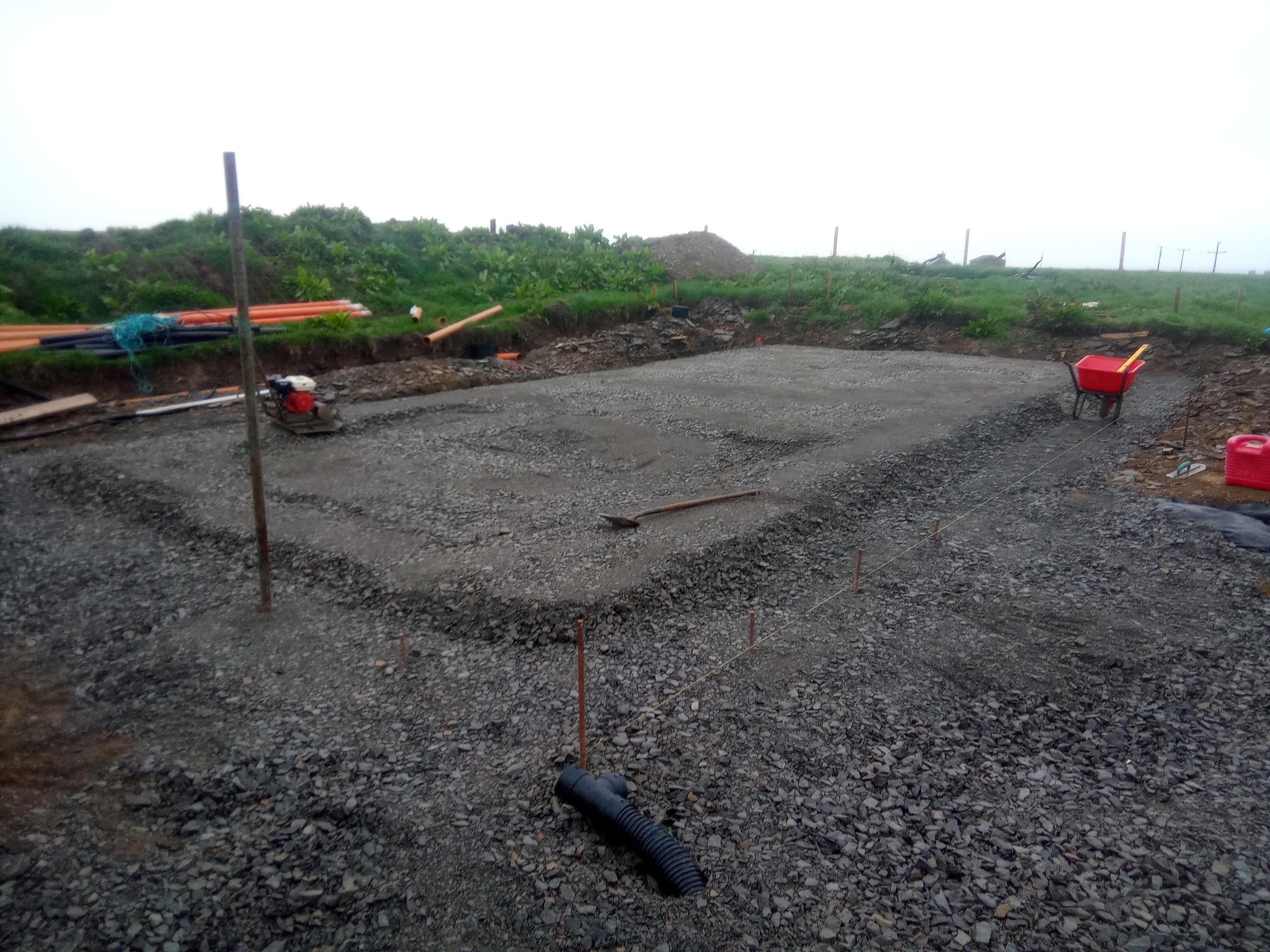

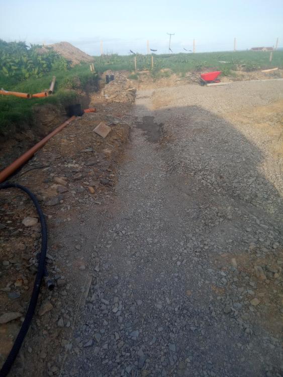

Starting on the North trench we barrow in the stone and compact.

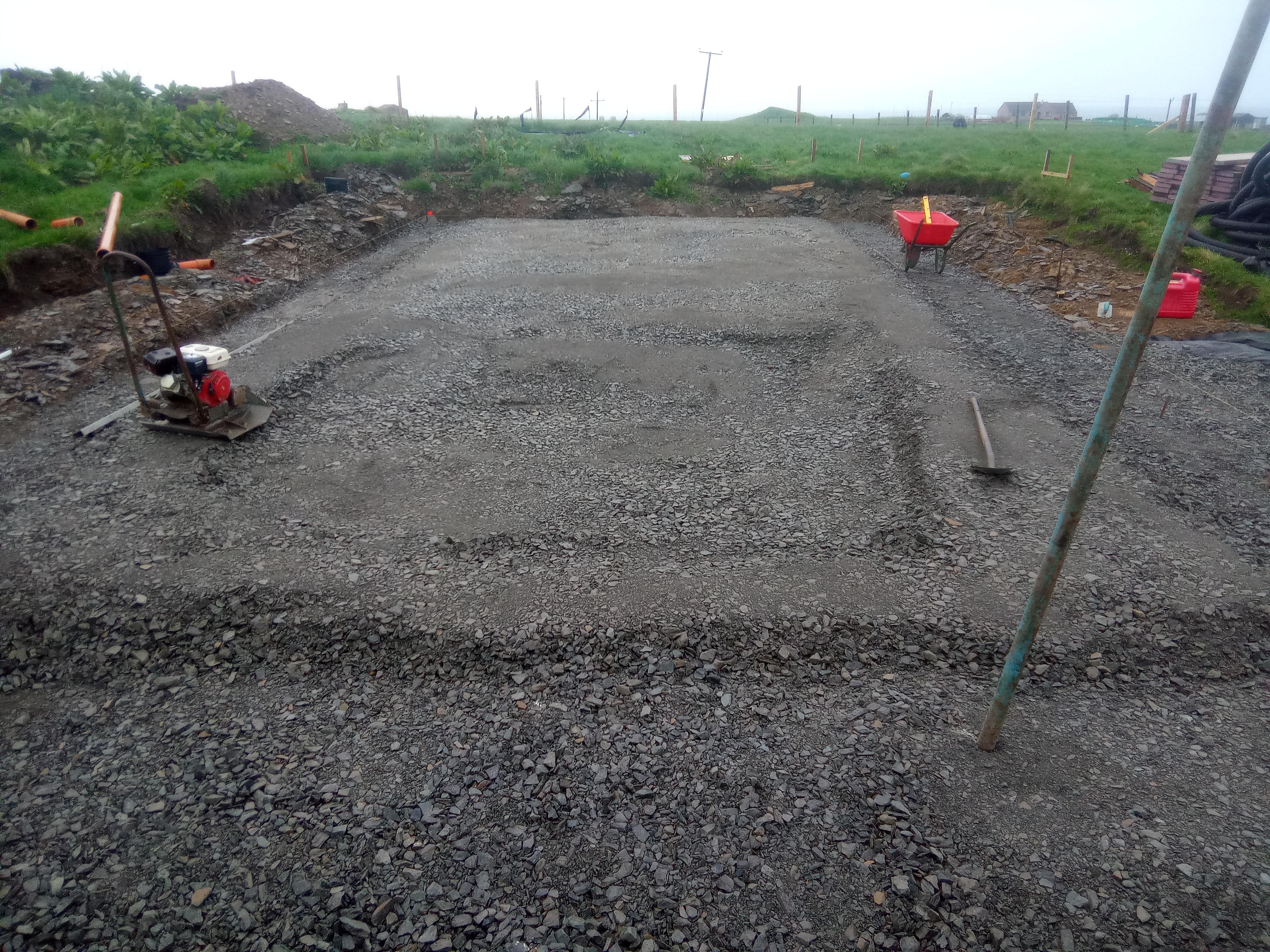

Adding more stone in layers and compacting, the backhoe loader was doing some of the grunt, but the leveling was all by hand, 100mm layers at time.
IMG_20230517_202813.thumb.jpg.852fe583307e3e77ae72468cd606ae49.jpg looking NE

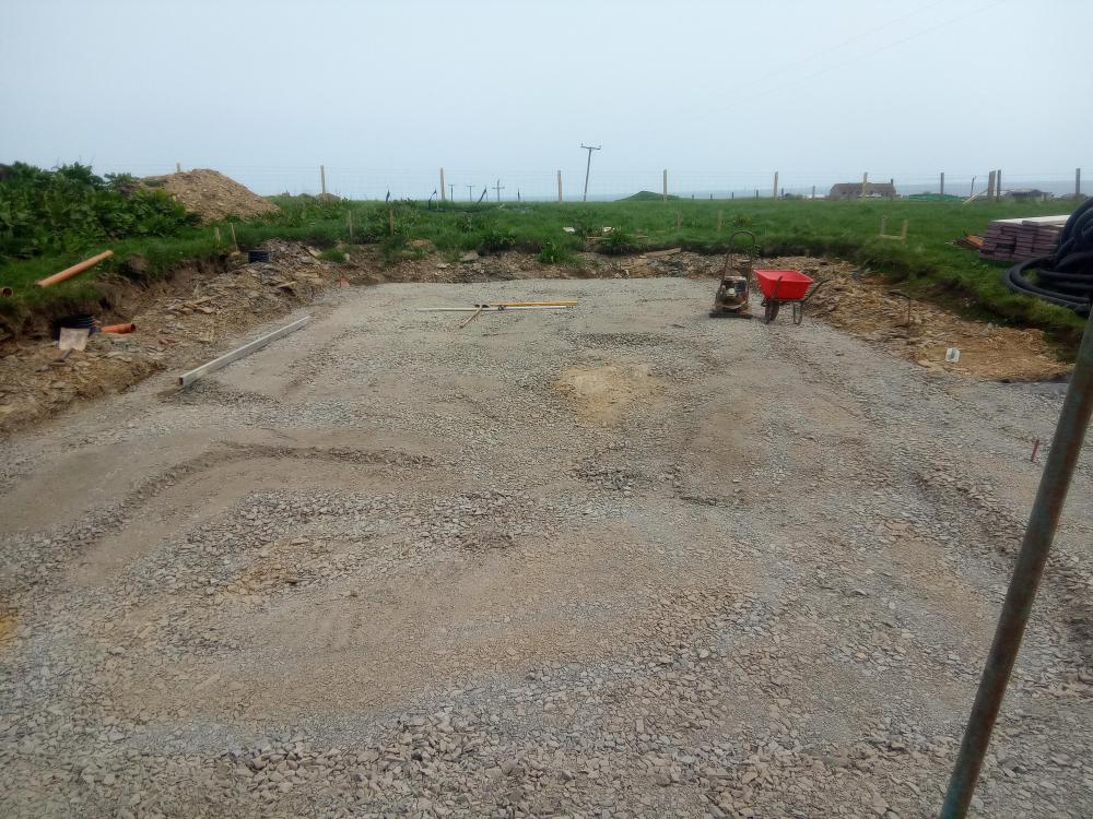

Took the decision to build the sub slab to what will be the same level as the strip footing, this allows for the Radon barrier to be put under the strip up the side and then on top of this sub slab, then all services will be above the  radon barrier and below the insulation in another layer of compacted hardcore.
The main reason for, what will be a fiddly taks of having the radon barrier under the strip, is that the strip footing has 288 starter rebars and sealing these penetrations would be worse.
Once the strip is poured we will finish of the back filling and install the radon barrier.
More stone looking East
So 5 days in me and Mandy have moved levelled and compacted 70T on 40mm to dust.
And around 5 ton of quarry dust, this is used up here as an alternative to grit sand for blinding and pipe bedding.

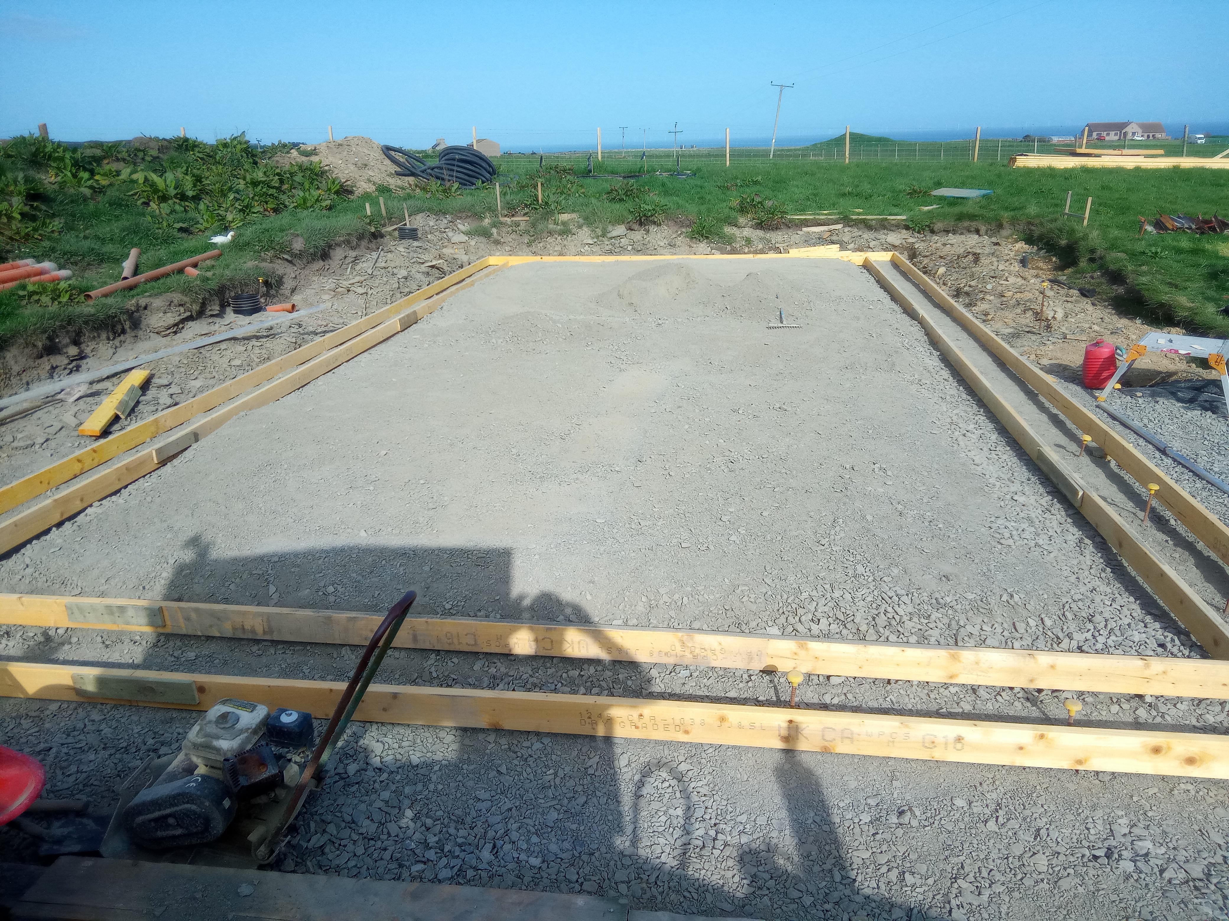

The shuttering is 150*50 timber that will be leveled then the radon barrier folded to form a tray, later to be joined to the slab. I'm going to use 6mm threaded rods to link the two shutters together, preventing any spread when the concrete is poured.

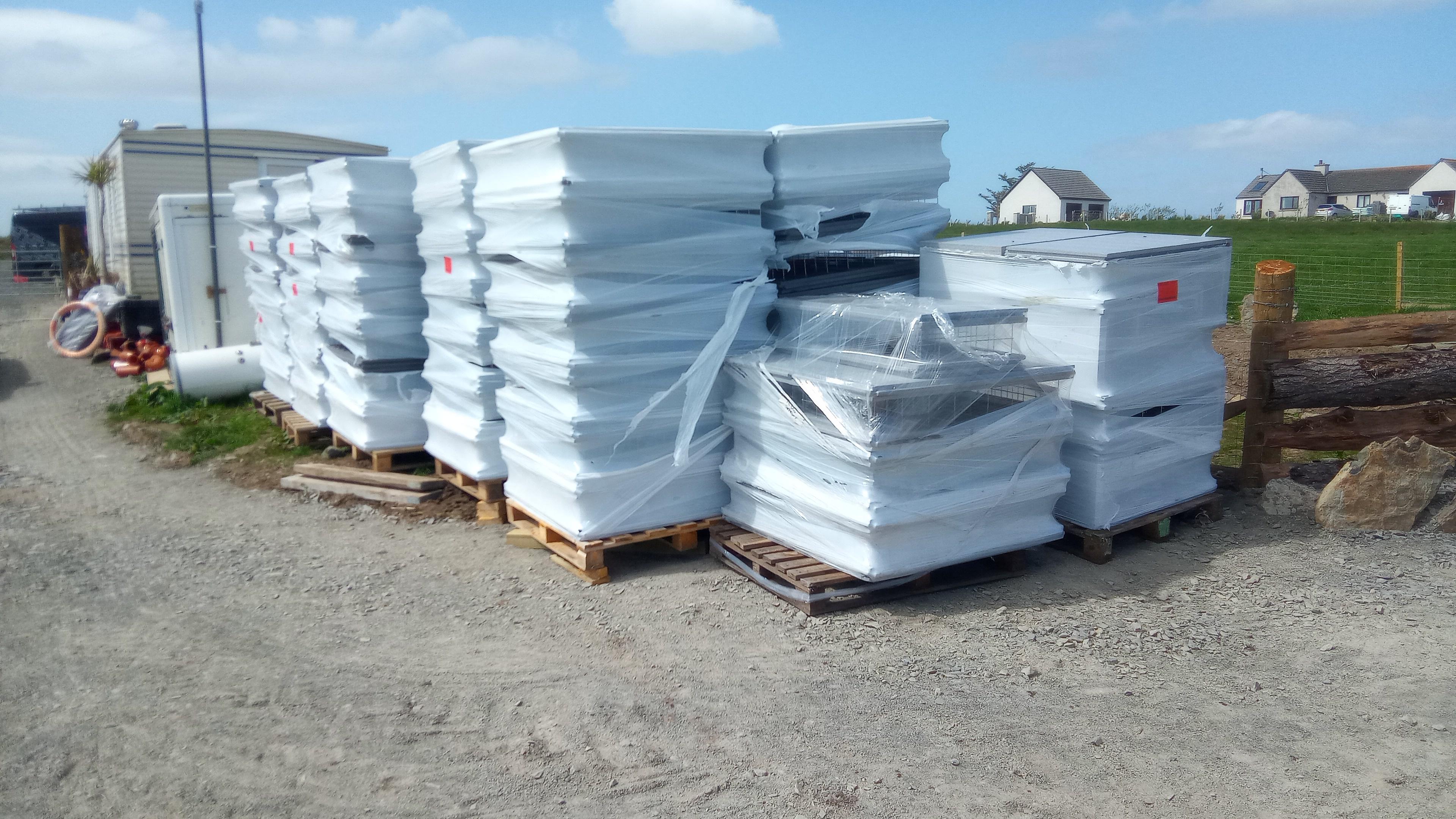

Hopefully next week the ICF arrives, in I've got a 10 hour round trip to collect rebar. For a tank of fuel and a days driving I can save around £500 collecting from Central rebar in Aloa.

I sat on the balcony with a cup of tea today, put 2 biscuits down while I got comfy and the wind blew one away.
So yes that ICF like that would worry me until tied down to something like stakes in the ground.
Link to comment
Worries me as well. It's got straps around all of the pallets to make them one lump,
Sheltered from the Westerly's by the static, and currently has my van protecting it from the Southerly winds. 🤞
Everything not bolted down moves here.
