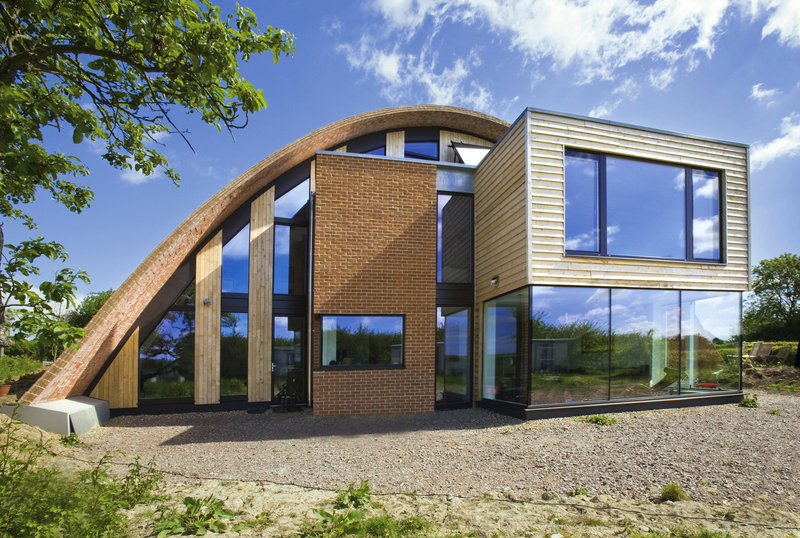

The only building I've heard of managing this feat in the UK was that amazing arched house that was on Grand Designs:
https://images.squarespace-cdn.com/content/531e5ec2e4b02c4ce263c44c/1456106421390-RYSUKC6L8BHZ75UJJ1BY/uk-passive-house?content-type=image%2Fjpeg
I really don't know how they managed it tbh. The arch is exposed internally along most of its length, and I can't see how they managed to insulate it at all, let alone to the sort of value that would been needed to meet the Passivhaus energy consumption standard.
Being on TV?  There are plenty of other with multiple whole walls of glass, where it make you wonder how the calculation adds up

5 minutes ago, JohnMo said:
Being on TV?
It's certified though. I can't imagine the PassivHaus Institute certifying a house that didn't pass the standard.
In this case, there's loads of glass AND an uninsulated masonry arch that makes up the vast bulk of the non-glass fabric.

Re the arched house (which I have driven past after a wrong turning) (the turf had slid a bit at that time)  : the external area will be relatively small which helps A/V.
And it is covered in turf which won't insulate so well when sodden or frozen as when dry.
While a curved surface does help with that, it's still quite a complex shape as a whole when you include the boxes that stick out from the arch. I remain unconvinced!
Link to comment
13 minutes ago, jack said:
still quite a complex shape.
Agreed...i looked at the picture again.
When brand new, the building was available for industry visits, but I never managed to go.
Since then, I think silence.
  • Like 1

Had a little dig into this, and rewatched the episode. As it happens they also redid their EPC this summer.
The episode discusses that the design is passive. And the epsiode includes an air test @ 33 minutes below.
His "High Five" accent reveals a Borat fan, I'd say !
Basically, the roof u-value is 0.13 (EPC = 92), and the arch is insulated on the outside under the green roof. It overhangs at the sides and that is where the uninsulated bits are - must be an interesting joining detail there.
Timber frame box walls are 300mm of newspaper clippings.
One point I did not remember is that the outside 2 layers of tiles (from 3) are laid in cement, whilst the inside layer is in plaster of Paris.
Drainage via a layer of terram or similar, filled with 20 tons of gravel:
